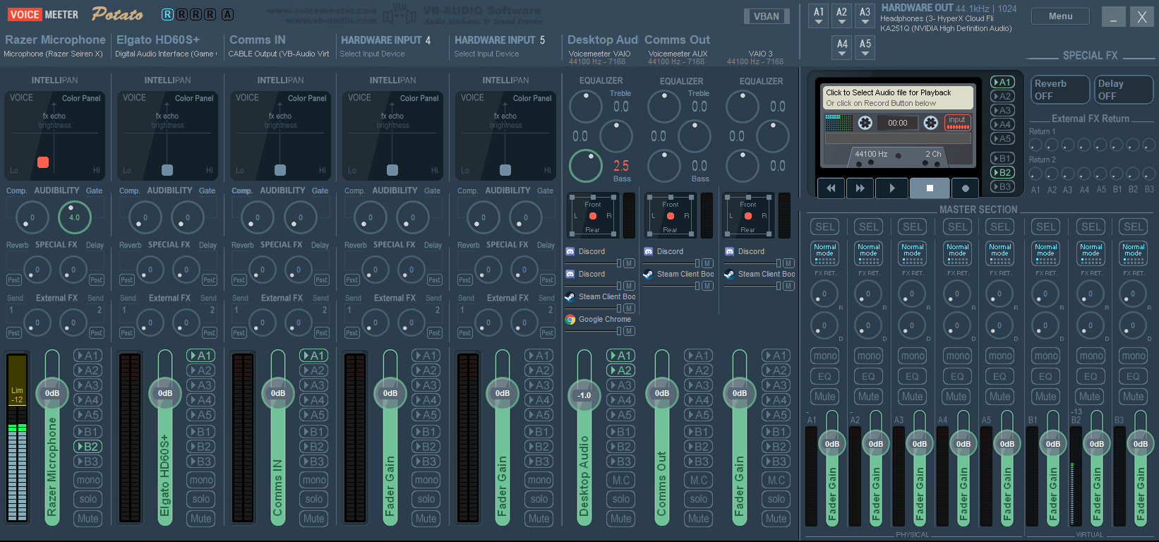

Hi all, it seems that my B2 output does not work anymore.
I've had this working for months, until yesterday I messed with settings and now it doesn't work. The only thing I changed was I uninstalled my virtual VB-cable and re-installed, and I feel that it has caused this issue.
My microphone is on Hardware Input 1, and it's routed to B2 which was how I got it to work before.

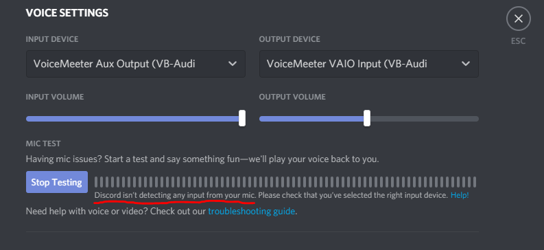

^ Here is discord not picking up any audio from Voicemeeter Aux Output
Would a full uninstall/ re-install of VoiceMeeter and its drivers fix this? I'm scarred that will cause more problems...

Re: Voicemeeter Aux Output is suddenly broken, please help
Why is B2 not slected for your Mic2? Is that the one you are using. What about your system settings?
Also check your VB Cable setingss. THis can be done in the VBCale tool. I had trouble with one of my VBCables and found the buffer size default was set too low..
Sorry, checking furrher it looks like you are not using VBCable. Maybe look at your System Sound preferences to ensure they match what you are seeing in DIscord.

SJC-OR , by Mic2 do you mean Hardware Input 2? Because that is my Game Capture device and I don't need that audio being sent to B2.
Either way I have figured out that there was an issue with the Voicemeeter AUX Output Driver. I uninstalled all Drivers for VAIO, AUX, VAIO3, and Virtual Cables, then reinstalled Voicemeeter completely and it worked for me
