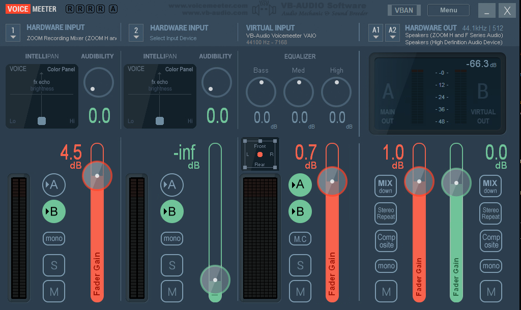

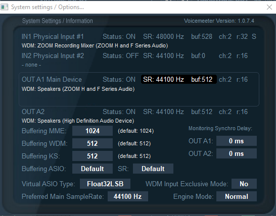

Thanks Andres. That seems to work, although the levels in Panopto seem a bit low and there is no input adjustment that I can see. The other issue is the latency as the drums are lagging the spotify track - is there an offset I can apply?
The interface is a Zoom H4n 2 channel USB running at 48KHz with 2 x Sure M57 mics. I attach the screenshots you requested.
Many thanks for your help.

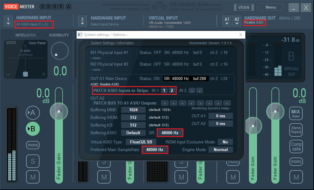

Hi. You could try to reduce latency by using ASIO instead of WDM. To use ASIO you need to install the Windows driver from Zoom Support (currently version 2.0.0.3) which includes the ASIO driver for your interface. Follow these steps to try out:
  • Save your current settings: Choose Menu - Save Settings... (You can use them later as a rollback plan)
  • Choose - remove device selection - from Hardware Input 1 dropdown
  • Choose the ASIO option for your interface in the Hardware Output A1 dropdown.
  • PATCH ASIO Inputs to Strips in the System Settings / Options Window by clicking the 2 boxes near IN 1.
  • Set the Preferred Main SampleRate to 48000 Hz and the ASIO SR (Sample Rate) at Use Preferred Samplerate.
Your setup should be similar to this (I don't have a Zoom Recorder but a Realtek ASIO):
