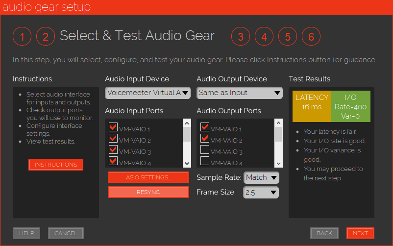

Update: I am getting improved results with the following adjustments:
  • Increased Voicemeeter Preferred Main Sample Rate option to 96000Hz: Since the device selected in A1 Hardware Output is the Main Device it sets the sampling rate used in Voicemeeter Virtual ASIO device. I selected a device that supports 96000Hz as A1 (Main Device); choose WDM option to force the use of the Preferred Main SampleRate.
  • In JamKazam Audio Gear Setup choose Voicemeeter Virtual ASIO - ASIO from the Audio Input Device list: This should start a latency and I/O test and show you results. Reported latency reduced to around 16ms

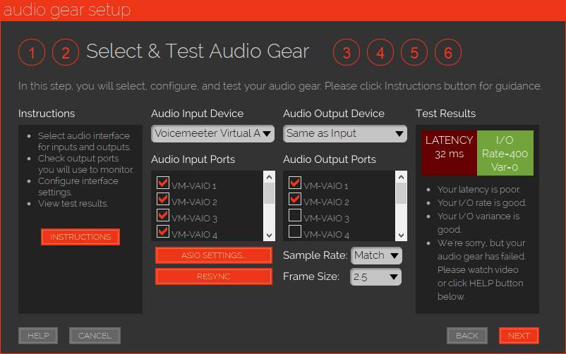

  • Results using 48000Hz as the Preferred Main SampleRate seems to be also more stable. Reported latency is higher.
    JamKazam Audio Gear Setup - Voicemeeter Virtual ASIO 48kHz.png (42 KiB) Viewed 8581 times
Of course this is just a synthetic test; the "real" test is to be able to connect your session to Zoom and get decent audio. Please let us know what are your results using Voicemeeter Virtual ASIO devices.
Update: Found this video on YouTube which describes how to use JamKazam with Voicemeeter Potato. It uses Voicemeeter VAIO3 Virtual ASIO.
Reported latency is around 4ms. https://youtu.be/-0hLl7R-FTI
