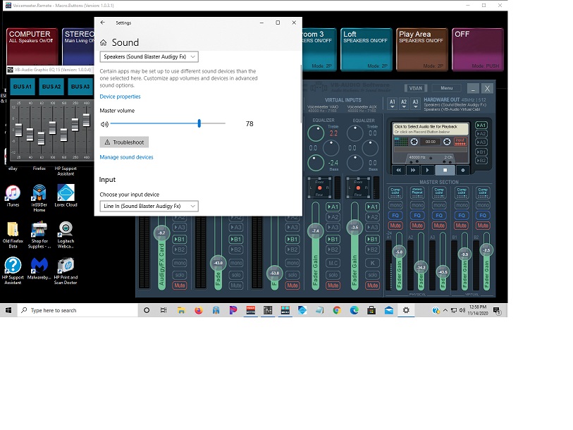

I have Voicemeter Banana set up where my inputs all come through the 2 Virtual Inputs. While the line is is one source it is not connected to a Virtual Cable. It is set to listen on the AUX Virtual input within Windows10. No matter what I have tried the actual physical Line In will not connected (even when the listen is set to SoundBlaster). When I set line in it shows signal to the A1 output bar regardless if physical set (no audio plays) or virtual (audio plays. I cannot take advantage of the Hardware input functions. Screen shots to follow.
Computer is HP with Intel Core i5-4440 CPU @ 3.1Ghz, 12 GB RAM.
Sound card is Soundblaster Audigy Fx
Here are the screen shots
WINDOWS SETTINGS (With Voicemeter in background showing meters and settings)
This is the setup that works with Pandora but not using hardware line IN.
1 - Physical In-Out settings in Windows 10.jpg (129.96 KiB) Viewed 20181 times

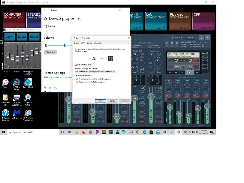

LINE IN LISTEN to go to Voicemeter
2 - LINE IN Settins to go to Voicemeter.jpg (133.01 KiB) Viewed 20181 times

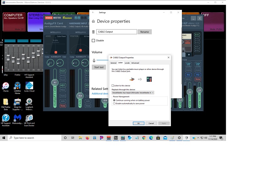

ATTEMPT (that does not work) to set virtual cable input as physical input
4 - Attempt to set virtual cable and then show the listen to device as AUX.jpg (109.45 KiB) Viewed 20181 times

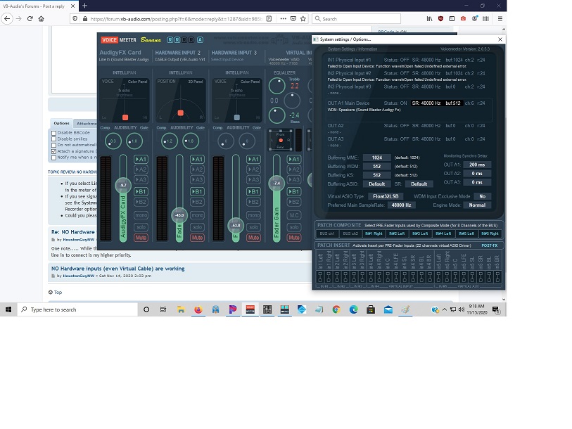

When the Line in is plugged in I can see the meter on the Windows10 settings move. However nothing shows on the Hardware In. Here is a screen shot of the System Options.
System Options
System Options
7 - System Options Settings.jpg (129.72 KiB) Viewed 20139 times
Re: NO Hardware inputs (even Virtual Cable) are working
Posted: Mon Nov 16, 2020 3:26 pm
Hi. According to the error message Voicemeeter is failing when trying to open both Hardware Inputs (using MME). I can't help you with this problem. (It is too specialized).
I would check if other applications can record properly using the Line Input; if they do I will try uninstalling and then re-installing Voicemeeter.
