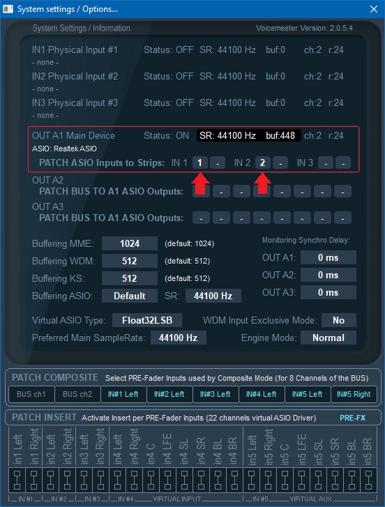

  • To connect your microphone to Hardware Input 1 (labeled AG03 Mic) and your bass to Hardware Input 2 (labeled AG03 Bass) use the following PATCH ASIO Inputs to Strips settings:
    PATCH ASIO Inputs to Strips.png (71.56 KiB) Viewed 15660 times
    This setup allows you to independently control your Microphone and your Bass. Please bear in mind that each input is mono.

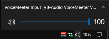

Anybody on Skype/Zoom/Discord can't hear any of the sound from the computer. Like if I play a track in Audacity or if I play something in MPC Beats. Or any other sound from the computer itself.
  • Select VoiceMeeter Input (VB-Audio Voicemeeter VAIO) as your default playback device in Windows. Voicemeeter will receive audio from all Windows applications that use the default device through the Virtual Input Voicemeeter VAIO (labeled Windows)

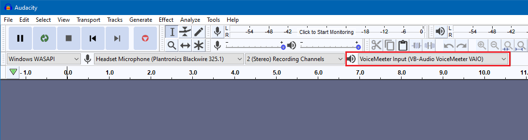

  • Applications like Audacity allows you to select the output device: choose Voicemeeter Input
