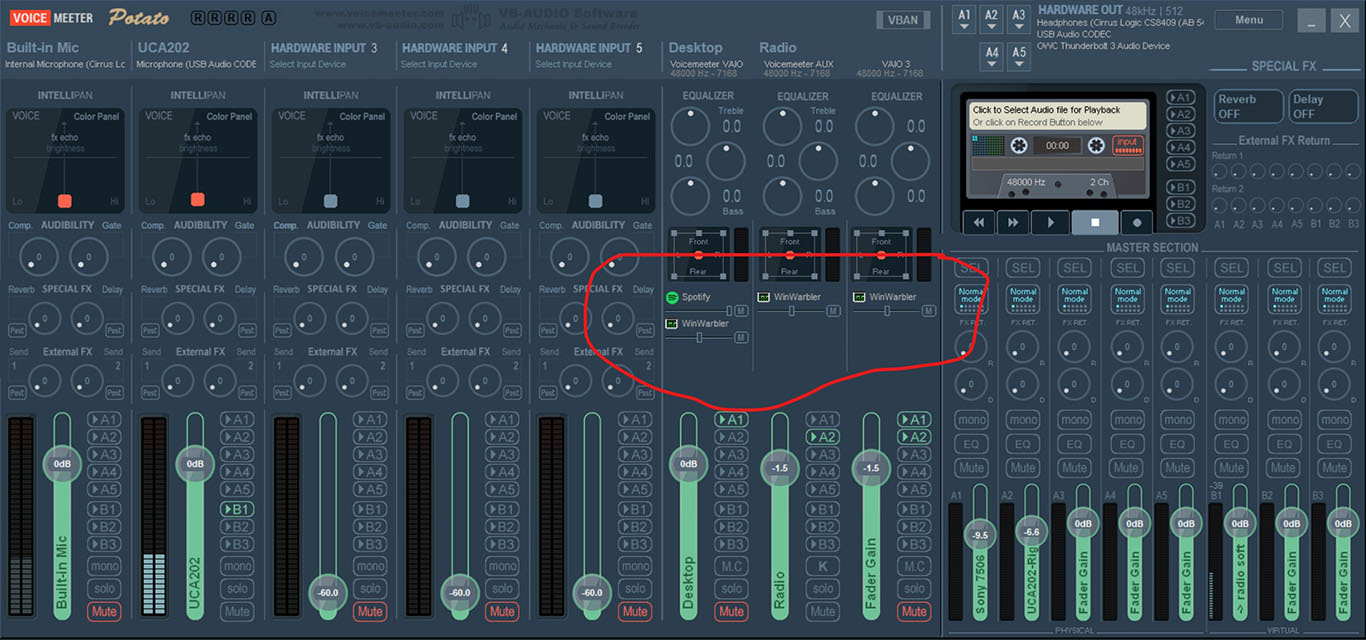

While playing with setup, specifically virtual inputs, I see that some software - Spotify for example - shows only on the assigned VI; other software (WinWarbler, a radio decoder/encoder receiving and sending audio) once it is started, it shows on all 3 Virtual inputs. Is it correct ? How do I get it only to show on assigned interface ?
As you can see, WinWarbler shows in all 3 virtual inputs.. and I spent last 2 days trying to restrict it to 1; reset/rebuild configuration, rebooted few times, connected, disconnected things - and I am stuck. Mercy, please :-)

Hi. The application list of Voicemeeter Potato reflects the state of Windows Volume Mixer for each virtual input device. There are other topics in this forum which discuss this issue. See for example: viewtopic.php?p=3734

Andres, thank you very much for the reply. As long as it is cosmetic, I can live with it; there are larger fishes to fry.
