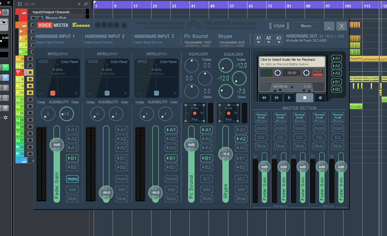

I've been using Voicemeter (Banana) as a way to work collaboratively over the web, using Cubase and skype/google hangouts.
But I have run into a slight issue (not a massive one, but would just like to check I am not missing anything obvious)
I have HW input 1 set to the line in for my mic, and I route that to B1
I have VAIO1 (Voicemeter VAIO) as my main pc sound for applications I set to output to it (so Cubase, media player, chrome etc) and have that routed to A1 and B1
I have VAIO2 (Voicemeter Aux) set to be the skypr of hangout autput, routed to A2.
So basically, I hear A1 and A2, and the person at the other end, just hears B1 (A mix of my pc sound and my mic)
When I go to set the outputs for A1 and A2 though, If I select "ASIO : MAUDIO Mtrack 2X2) << i.e. my devices main asio driver...I get no output.
I have to select KS, or WDM drivers for those outputs to make it work.
So it works fine, but I'm wondering if I am getting the best performance (cubase latency, asio performance etc) by not being able to chose the maudio's asio driver as an output.......or does it not really matter?
have attached a screenshot of my current mixer frontend if my writing above doesn't make sense.

should be better to select the M-Audio ASIO driver as output A1 device (and use ASIO patch to dispatch ASIO channel in Voicemeter)
it does not appear in the list ? maybe the 32bit ASIO interface is not installed ?

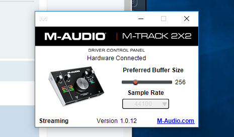

As for their control panel.. it's very barebones, just a buffer slider, and a monitor to show if it's "streaming" audio or not.
M-audio's control pana
As far as I can tell (unless something weird is running in the background that I don't know about) I don't have anything running that could be stealing the audio device.
Like I say, I can use the m-audio asio as a device in cubase (or windows etc) without voicemeter, and it seems to be working fine. Just when I try to route via VM, it thinks there is no sound :( .. if I go into windows sound properties when VM is being slient on me, the 'volume test' meter in there shows audio is on the voicemeter input.. it just never arrives at banana for some reason.
