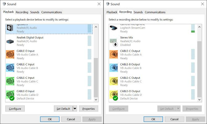

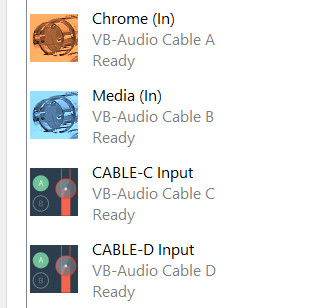

A+B stay the same after reboot - would it hurt to let the other ones do the same? Or is that a bug with A+B?
Additionally, the icons for C+D are incorrect.

It seems even after fully re-installing, C & D just won't display correctly. I didn't even get to installing Potato back at this point.
I've tried uninstalling and re-installing twice - is there something else to try to ensure these behave right?
