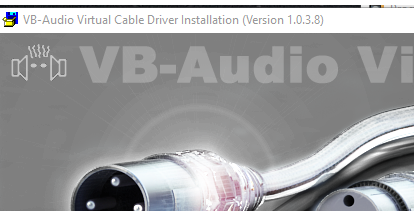

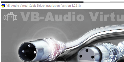

by skullmonkey
I downloaded the latest version, installed and I still get Version 1.0.3.8
This is from VBCABLE_A_B_Driver_Pack43
This is from VBCABLE_Driver_Pack43.zip
Am I missing something?
