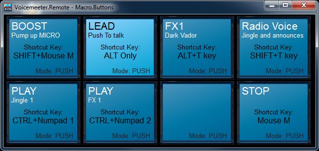

With the latest Voicemeeter Pakage 2.0.2.3 , MACRO Buttons application is now installed with Voicemeeter
and can be used to control Voicemeeter by buttons, for example to make PUSH TO TALK functions, or FX or even make a Sound Board.

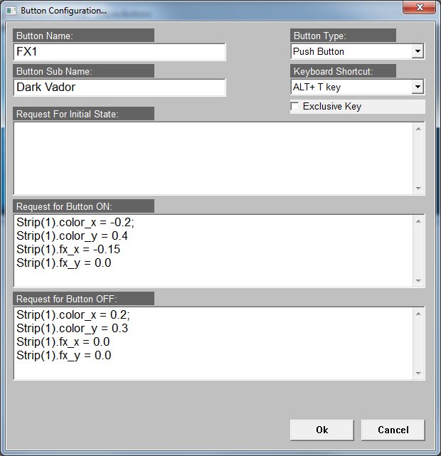

Each button is programmable by using Voicemeeter Remote Requests (right click on the button to get the dialog box below)
it provides basically 3 possible script:
- Initial : to possibly fixe the initial control state (when the application is launched - Voicemeeter or MacroButtons).
- ON: the request(s) sent when pushing the button
- OFF: the request(s) sent when releasing the button
A keyboard key or mouse button can be associated to one or several button (possibly exclusively).

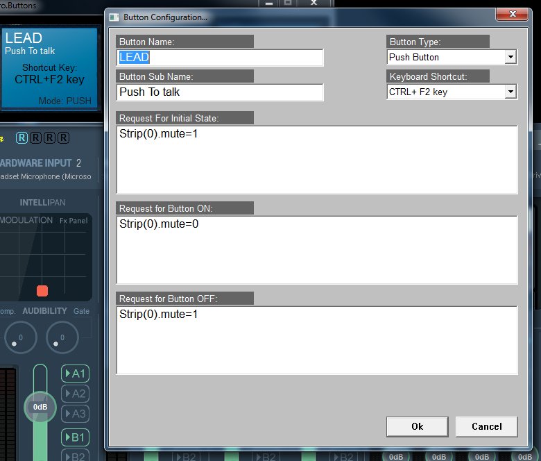

With MacroButton Application it's now easy to make one or several PUSH TO TALK buttons
As Initial state, we want to set the strip as muted (mute=1).
when we push the button, we unmute by sending the appropriate request (mute=0) and we mute again on button release.
It is also possible to manage other strip by adding some requests, for example to set the music strip to -10db when talking and reset it to zero dB on button OFF...

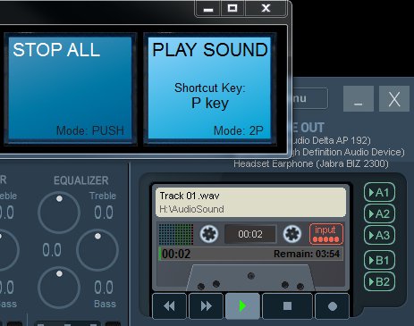

With the recorder's requests it is possible to use the Macro Button Application as Sound Board to remote the Banana Player to launch sounds (one sound at a time).
For example, this request below will ask to Voicemeeter Banana to playback
the Track 01.wav sound located in the H:\AudioSound directory.
recorder.load="H:\AudioSound\Track 01.wav";
If the option Play on Load is not set, you will have to add a request to play it
recorder.Play=1;
To Stop the Banana Player:
recorder.stop=1;
With Voicemeeter Version 2.0.2.3, it is also possible to set the gain (in dB) of the playback:
recorder.Gain=-10.0;
