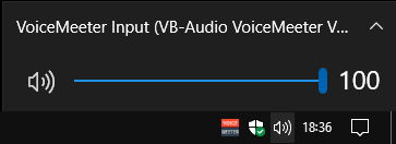

  • Select VoiceMeeter Input (VB-Audio Voicemeeter VAIO) as your default playback device in Windows. Voicemeeter will receive audio from all Windows applications that use the default device through the Virtual Input Voicemeeter VAIO (labeled Windows)

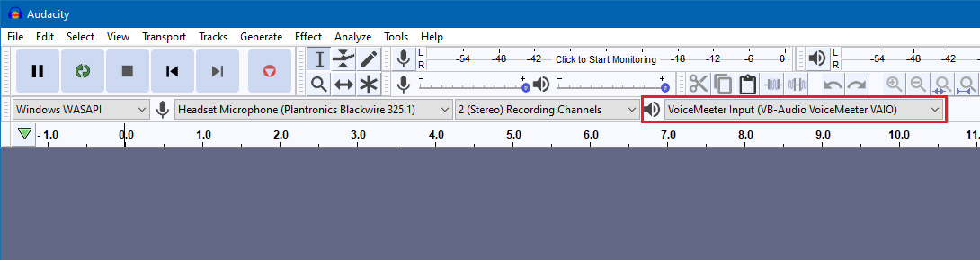

  • Applications like Audacity allows you to select the output device: choose Voicemeeter Input
