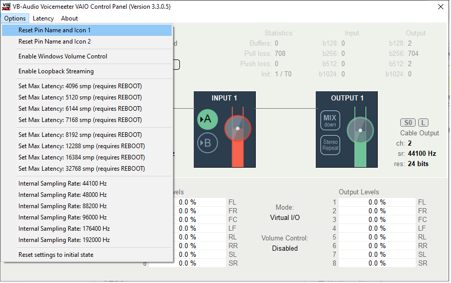

Posts: 2225
Re: windows 11 - voicemeter crashing
according your driver checker log, Voicemeeter VAIO are not well installed. possibly because you did not reboot after installation.
if Voicemeeter VAIO have not the right name (and icon) these cannot be used by applications.
To fixe your problem, run VBVoicemeeterVAIO_ControlPanel.exe in administrator mode
(you will find it in C:\Program Files (x86)\VB\Voicemeeter folder).
then go in menu to select "Reset Pin Name and Icon 1"
Some VB-CABLE seems to be not well installed too... thanks to post your Windows Device Manager screenshot (section "Audio, video and game controller").
If you cannot fix your problem, you may consider uninstall Voicemeeter and VB-CABLES, and reinstall them correctly (by rebooting your computer on each step - ). more info: viewtopic.php?f=7&t=688

I can confirm they have been uninstalled restarted reinstalled restarted several times all with the same results!! Surely I cant be the only user having these issues with windows 11 25H2?
Posts: 2225
if you have redefined Pin name of your VB-CABLE A+B, you must ignore this error. this should be considered as warning instead (i will check the DriverChecker program).
