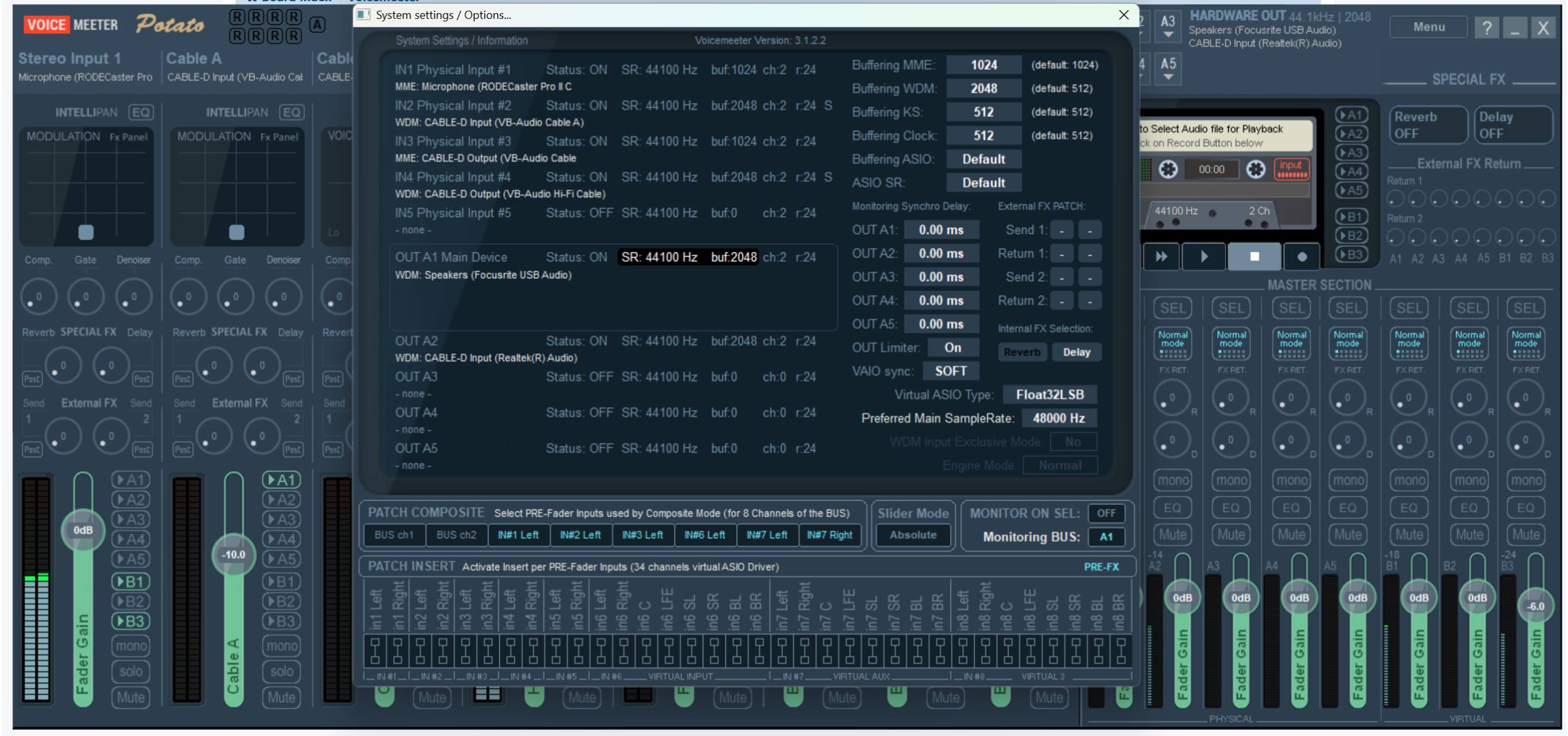

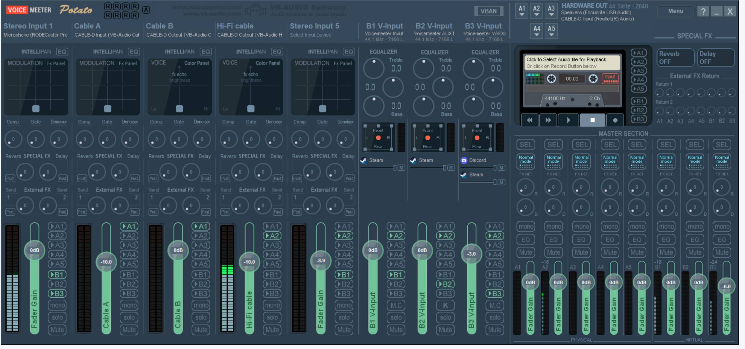

you may post a screenshot of your Voicemeeter and a screenshot of its system settings dialog box.

So sorry for the delay. I had turned off Exclusiveness and the problem was gone but tonight when I want playing fortnite with started happening again.
