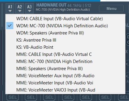

Hi Vincent,
Thanks!
I don't use MME, only a WDM device:
WDM Device.jpg (52.96 KiB) Viewed 17905 times

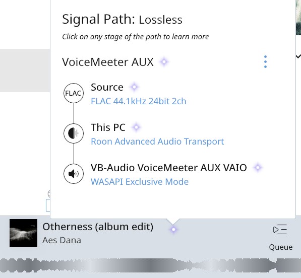

I use VAIO1 as default audio device configured without exclusive mode
I use VAIO2 (AUX) as audio device for exclusive mode enabled applications (Tidal, Roon) to bypass Windows audio mixer and configured with exclusive mode (In both the Windows audio device configuration and the general WDM Input Exclusive Mode in VoiceMeeter)*.
Perhaps related?
*Not sure about the sonic benefits for this but I do get emotional reassurance ;) from Roon's purple lossless indicator, available only for Exclusive Mode:
I'm aware that VoiceMeeter is still a software mixer in the path, so not really a direct path to device as Roon believes in this configuration but I do trust VoiceMeeter's audio path more than Window's and in any case I guess one less software mixer/resampler in the path for these audio apps.

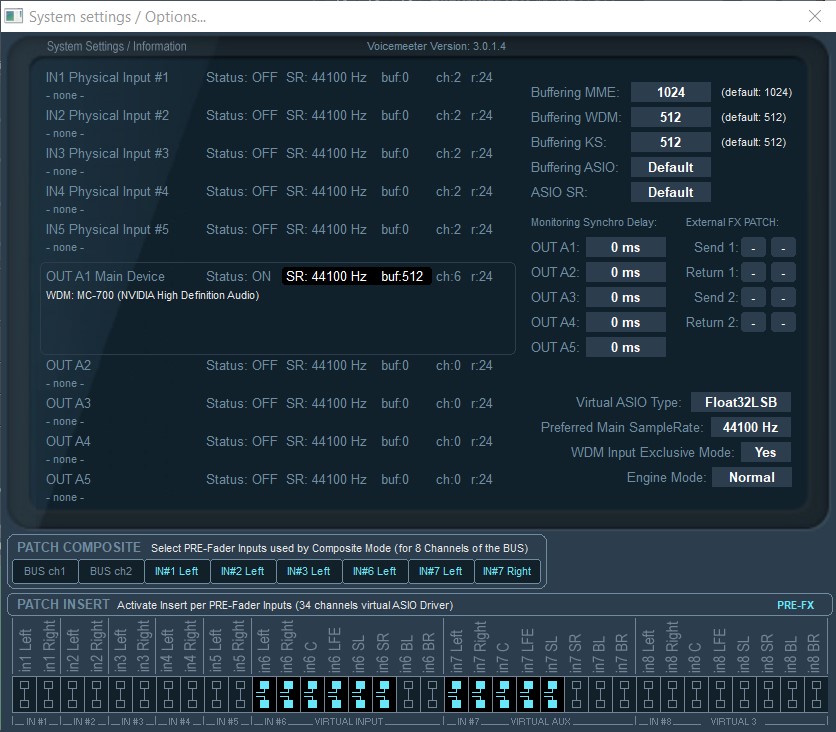

ok, so i would say you should not set WDM Input exclusive mode to YES in Voicemeeter
(but you have no hardware input so should not have incidence).
i also recently bought an Emotiva MC-700 and i'm not fully happy with this device... should start by this one.
Voicemeeter cannot freeze because VAIO (whatever you connect on) and cannot freeze with Virtual ASIO (because totally not in same process).
Re: Potato UI freezes/unresponsive after extended sleep
Posted: Mon Jan 04, 2021 8:21 pm
by ronkuper
Yes the MC-700 has some HDMI quirks. The only reason I switched my graphic card from Intel to nVidia is that MC-700 didn't allow 5.1 in the Intel one (tested on multiple PCs, some EDID compatibility issues with the Intel driver probably).
Interesting - from your message I understand that VoiceMeeter WDM Exclusive Input setting is only relevant for the hardware inputs and not the VAIOs?
VAIOs exclusive mode is set and determined only from the Windows playback device properties?
Posted: Tue Jan 05, 2021 8:47 pm
difficult to know what the MC-700 does in term of decoding - especially for the LFE.
anyway, yes, WDM Exclusive input option is for selected input device only (VAIO are driven by a special and direct channel by Voicemeeter).
you may set this option on 'No' to be sure it has no incidence.
HDMI can bring many problem as far as i see... including freeze...
