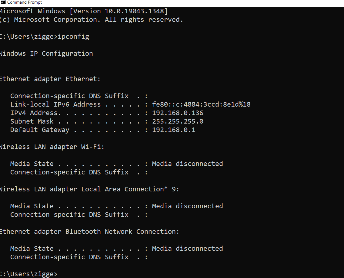

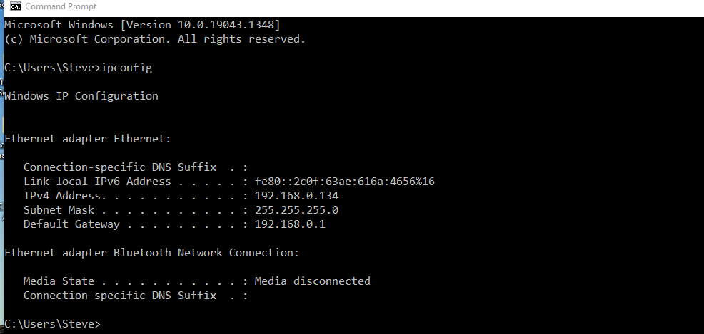

could you go in command prompt and type "ipconfig" in each computer and share the result here.

Here are the screenshots.

Posted: Mon Nov 22, 2021 8:27 am
ok, IP are ok.

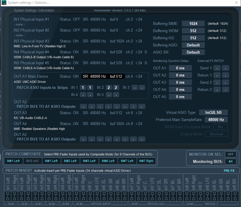

ok, could you post the screenshot of the Voicemeeter System settings dialog box of the PC not detecting stream (134) ?

Here you go.

Posted: Mon Nov 22, 2021 8:21 pm
ok, i see nothing wrong, i've no more idea except to use another ethernet switch ... or check wire connection (plug).
