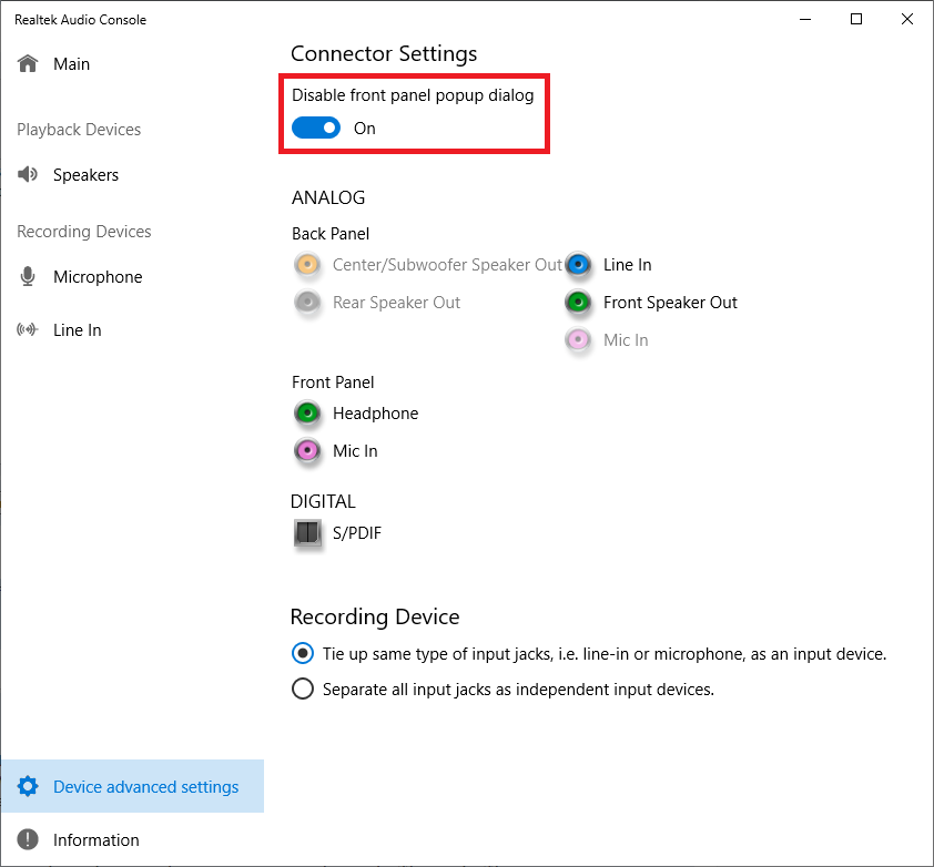

Hi. This is not the answer to your question but a simple comment assuming you are using the motherboard integrated audio solution: In most desktop PCs headphones connect via a 3.5mm stereo jack on front panel which typically includes jack-detection capability. Some audio drivers allows you to disable front panel jack detection which could be helpful is that is your case. One example using Realtek Audio Console:

Andres wrote:Hi. This is not the answer to your question but a simple comment assuming you are using the motherboard integrated audio solution: In most desktop PCs headphones connect via a 3.5mm stereo jack on front panel which typically includes jack-detection capability. Some audio drivers allows you to disable front panel jack detection which could be helpful is that is your case. One example using Realtek Audio Console:
I should have mentioned that I am on a laptop, so I am using the motherboards integrated sound I assume. I do have RealTek Audio Console, but it tells me that it "Can not detect an RCP service."
But when I plug in my headphones, my sound comes on immediately without VoiceMeeter. I used to have a dialog, but I did something ages ago to get rid of it because I found it annoying. Since the computer automatically knows what to do with the headphones, I don't think this would be the issue.
