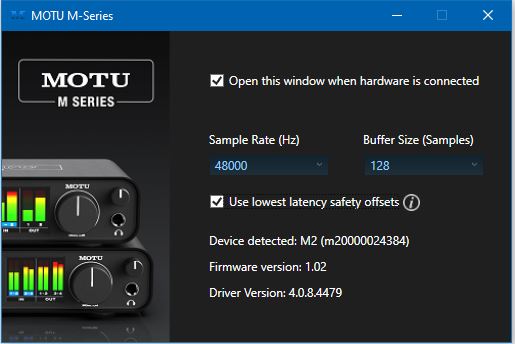

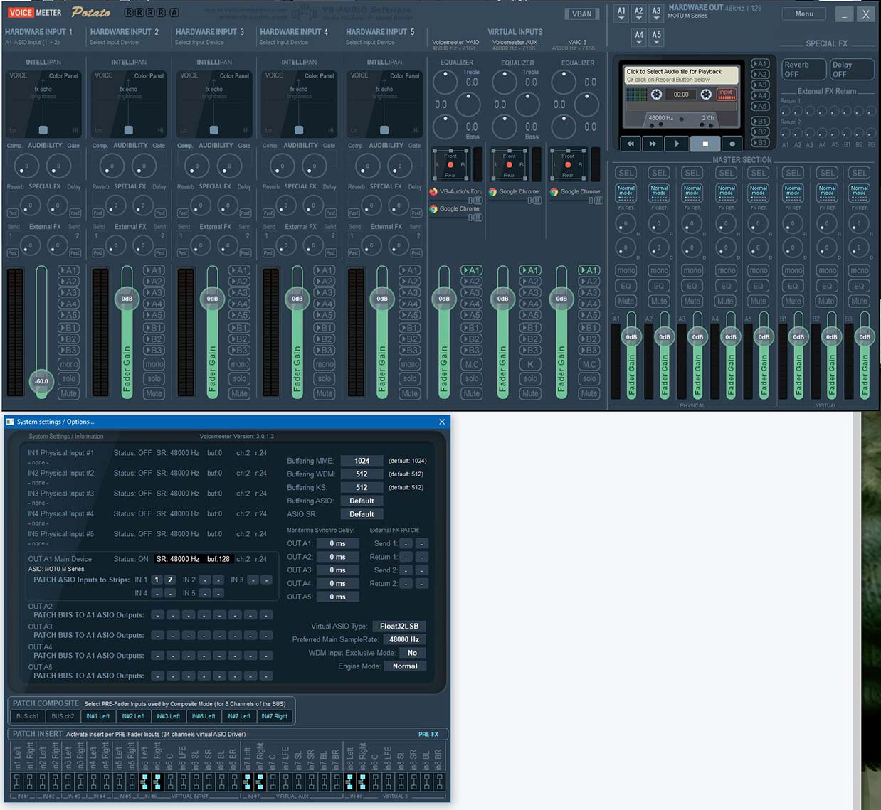

I'm using a MOTO M2 as the A1 ASIO device. I'm sending channels 7/8, 15/16, and 23/24 to the virtual ASIO driver, and using the Voicemeter (Potato) Insert device in Ableton. When using Banana this setup works flawlessly, but when I switch to Potato it doesn't work at all.
For example, when I set the system audio device to Voicemeter Input (channels 7/8) there is no audio unless I deactivate channels 7/8 in the patch insert settings.
Anyway, the strange thing is that the same settings work in Banana, but I'd really like that third channel available so I can put spotify and desktop audio on separate channels (there's a plugin for spotify called equalify that lets you change the audio device for spotify).
All audio interfaces are set to 24-bit/48KHz in the windows sound control panel. The MOTU ASIO driver is set to 48KHz/128 samples. Here are screencaps of my settings (in Ableton, the input config is using the same set of stereo input channels that the output is using):

Thanks for replying. The I/O routing in Ableton is configured correctly; that's why it works in voicemeter banana. That's the issue I am having. The setup works perfectly with Banana, but not Potato. If you look at the screenshots I posted of the configuration, it is exactly the same in Banana with the exception of the extra 23/24 channels. The configuration is:
In voicemeter: activate patch insert 7/8, 15/16, 23/24;
In ableton:
When the system output device is Voicemeter Input, this should route the system audio into the audio track in ableton, then from ableton to the Voicemeter VAIO channel in voicemeter. It works in Voicemeter Banana, but not Voicemeter Potato. That's why I'm trying to get some help; it appears that the problem is not with the configuration, but with Voicemeter Potato itself.
In ableton:
- select voicemeter potato insert as ASIO device;
- activate stereo inputs 7/8, 15/16, 23/24;
- activate stereo outputs 7/8, 15/16, 23/24;
- On an audio track, select External In channel 7/8, and External Out 7/8;
- Turn on monitoring on the audio track;
