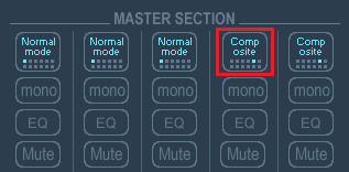

Hi. In Voicemeeter you can select the COMPOSITE mode for virtual outputs (and hardware outputs) to "compose" the 8 output channels from the different input channels.
composite mode.png (4.96 KiB) Viewed 23277 times

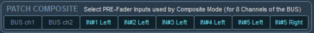

Voicemeeter Banana and Potato provides the PATCH COMPOSITE section in System Settings / Options... windows. You can compose your signal PRE- or POST-Fader
patch composite.PNG (142.31 KiB) Viewed 23292 times
In Voicemeeter Basic patch composite is fixed and only PRE-fader.
For more information see Voicemeeter Banana User Manual, page 19.

Hi. Try the following settings in PATCH COMPOSITE:

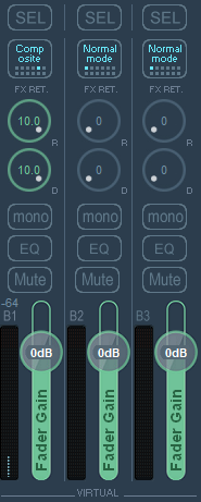

Since you are sending the four inputs to B1, remember to set B1 output in Composite mode (Master Section). If you want to preserve the fader settings of each input use POST-Fader in PATCH COMPOSITE.

I'm still missing something... what's the "Master Section"? I don't know what "set B1 output in Composite mode" means.

OH! Got it. Thank you so much!
