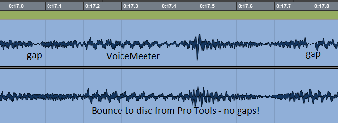

The Pro Tools audio, after passing through banana, has a 19 millisecond gap every 714 milliseconds. See attached graph of an 800 millisecond sample before and after passing through VoiceMeeter. I have tried many different buffer sizes, and I have also swapped the internet and Pro Tools virtual inputs. The Pro Tools audio is still useful for instructional videos, but obviously it sounds "clicky". Any thoughts or suggestions would be appreciated.

The stability of our Virtual ASIO driver are mainly pending on voicemeeter main stream (given by output A1 device).
the needed information to help is the voicemeeter system settings dialogbox screnshot.

Here are the system settings. I have tried larger buffer sizes (up to 1024) on the FocusRite ASIO.
- vb banana.jpg (143.38 KiB) Viewed 18408 times

ok, you have the focusrite device...
well, so you may investigate in buffer size / samplerate parameter to find a stable configuration...
quickest workaround is maybe to use the WDM driver instead of ASIO in your case...
as it is explained there:
viewtopic.php?f=11&t=506

Yes, so Vincent pointed out there are some issues with the Focusrite ASIO driver. He posted a link to the discussion so as he is the expert, it is probably best to take his advise and use the WDM driver instead in Ovicemeeter but then leave Pro-Tools to interface with VAIO drivers.
- Posts: 2212
Re: Pro Tools glitches
you may first use ASIO driver as Voicemeeter output A1 (maybe with 512 sample buffer instead of 256).
and normally connect your Protools to Voicemeeter Virtual ASIO driver.

The WDM driver is working great with 1024 buffer size (nothing less works).
Latency is not good enough for recording, but the sound is great on playback.
I would love to whittle the latency down, but this is good enough for now.
