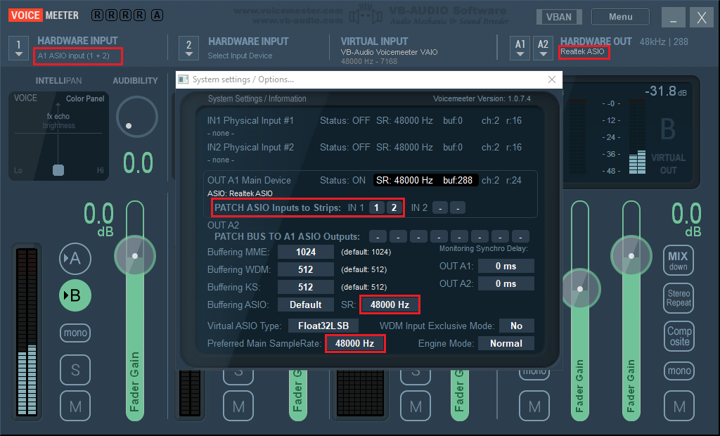

Hi. You could try to reduce latency by using ASIO instead of WDM. To use ASIO you need to install the Windows driver from Zoom Support (currently version 2.0.0.3) which includes the ASIO driver for your interface. Follow these steps to try out:
  • Save your current settings: Choose Menu - Save Settings... (You can use them later as a rollback plan)
  • Choose - remove device selection - from Hardware Input 1 dropdown
  • Choose the ASIO option for your interface in the Hardware Output A1 dropdown.
  • PATCH ASIO Inputs to Strips in the System Settings / Options Window by clicking the 2 boxes near IN 1.
  • Set the Preferred Main SampleRate to 48000 Hz and the ASIO SR (Sample Rate) at Use Preferred Samplerate.
Your setup should be similar to this (I don't have a Zoom Recorder but a Realtek ASIO):
I can't advise you about how to properly record a drum kit. I know a lot a people uses Shure SM57 microphones so you should be OK with them. Phase cancellation could be an issue when using multiple microphones and result in a very weak signal.
The only suggestion I can make is to start by monitoring through your Zoom recorder by connecting your headphones to the [LINE/PHONE] 3.5mm jack and activating the MONITOR function in the USB AUDIO I/F MENU. If the audio level in the Zoom recorder is what you would expect you can start to debug your setup.
