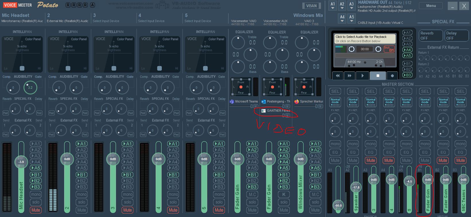

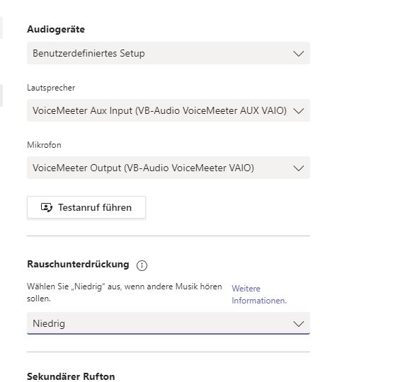

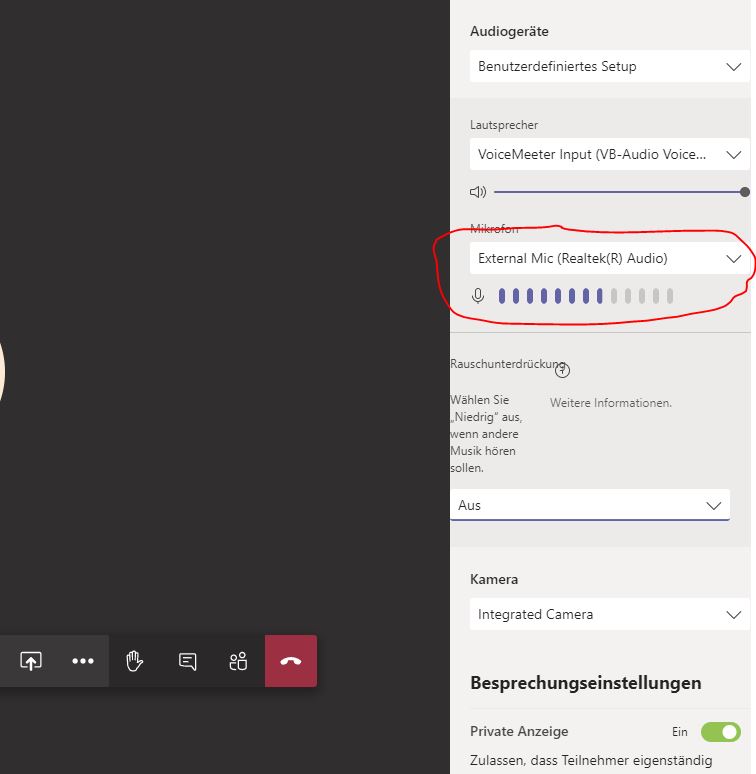

Ok, here some screenshots:
a) Teams with external Mic, works perfectly fine
b) Teams with "Sound" from Voicemeeter - Video Sound from VLC:
VLC Sound Output ----->>>>> Voice Meter Input AUX ------>>> B1 virtual Output ----->>>> Microphone in Teams "Voicemeeter Output VAIO)

  • Microsoft Teams recommends you set the noise reduction level to Low or Off when you need the other people to hear music. I see that you made your tests using the Low option.
    montafon wrote: Thu Dec 10, 2020 3:55 pm a) Teams with external Mic, works perfectly fine
    Did you use a music source in that test?

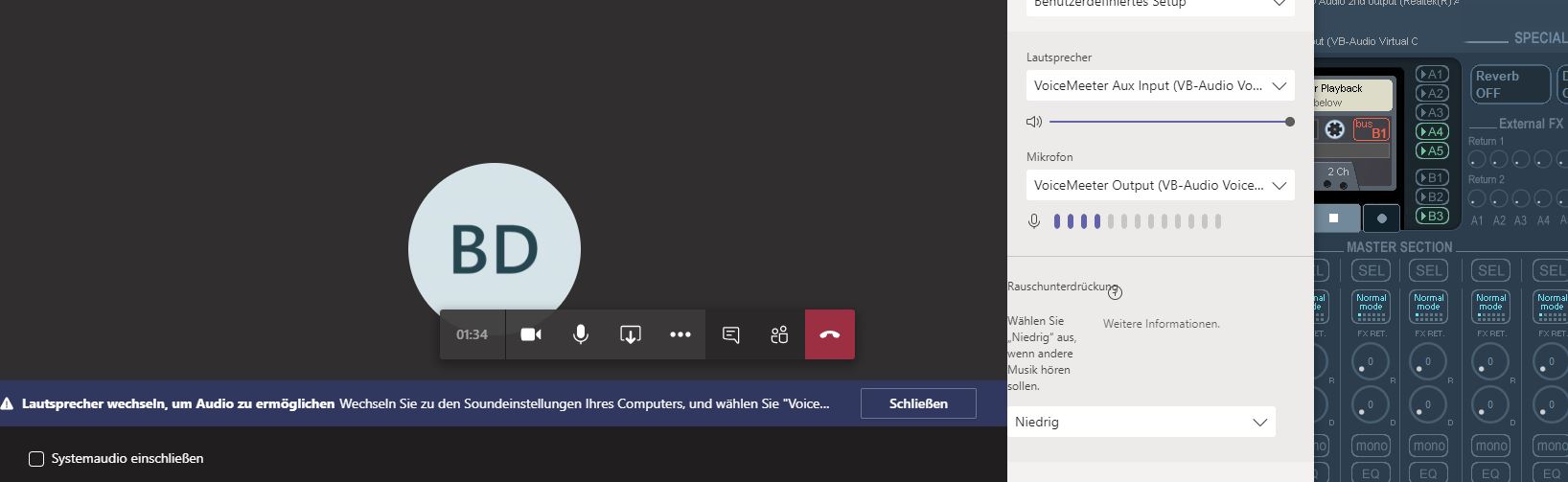

What unfortunately I did not get working is that sharing the screen and using "include computer sound" to get a Voicemeeter output as "computer sound". I MUST change back to sound settings without voicemeeter. It seems that Teams does not accept Voicemeeter as "system sound".

Hi. To Include computer sound using the Share content control, Microsoft Teams speaker device and Windows Default Playback device should be set to the same device. See the second note here: https://support.microsoft.com/en-us/off ... 061a0d8e3b
So for example if you are using Voicemeeter Aux Input as your Speaker in Teams, you should select that device as the Default playback device in Windows.
Is it possible to use the same device in your setup?
