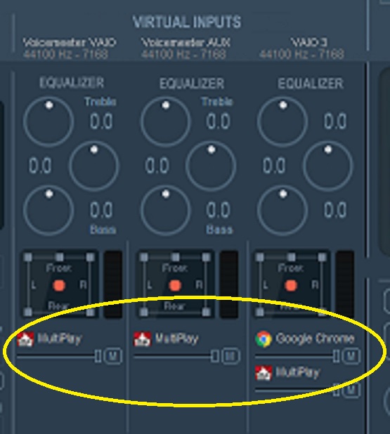

To Both- I see something peculiar in VoiceMeeters virtual input section but after searching this forum, apparently that's not usual but it can be misleading. (see attached screenshot)
VM Virtual Inputs.jpg (69.87 KiB) Viewed 32030 times

Just discovered something peculiar regarding the virtual input channels displaying the same app in all 3 channels (see my screenshot a couple of posting earlier).
I normally start Potato (non-administrator mode). When I start another app (also in non-administrator mode), that same app can appear in all 3 virtual inputs even though I'm pointing the app to use a specific input (VAIO3). Both in Windows 'App volume and device preferences' and in the app itself. The audio is routed correctly.
However, if I change the app to 'run as administrator', then it doesn't show up at all in Potato. yet the audio from the app continues to work. No other changes.
If I change Potato to 'run as administrator' and the other app also as administrator, the app appears in all 3 virtual inputs again.

That is normal behaviour. The app appearing in all three devices is a windows bug. The visibility of the administrator's activities being limited to administrators is intentional, to give privacy/security to system administrators.

That's unfortunate. I understand what Admin mode is for. I just found it interesting that the way the Apps are displayed is different depending on the modes.
Personally, I think it would be better if the Apps weren't displayed at all in Voicemeeter. It just makes things confusing. After all, the column heading can be changed to display whatever you want. This is what I did when I set it up. But during actual usage, I might not be the person sitting at the computer to tweak levels etc. and with the Apps displayed, it definitely confuses them because their eyes are drawn to it rather than looking at the column heading. I think it would also be helpful if the user defined column heading was a different color or stood out in some way. Currently it blends in with the actual name of the virtual input.

no it's the application itself, openning all devices (so appearing on all mixer), this is the same problem with Discord and probably coming from a shitty common library (e.g. webrtc).

I will discuss with the developer of one of the Apps I use that show up in all virtual inputs.
