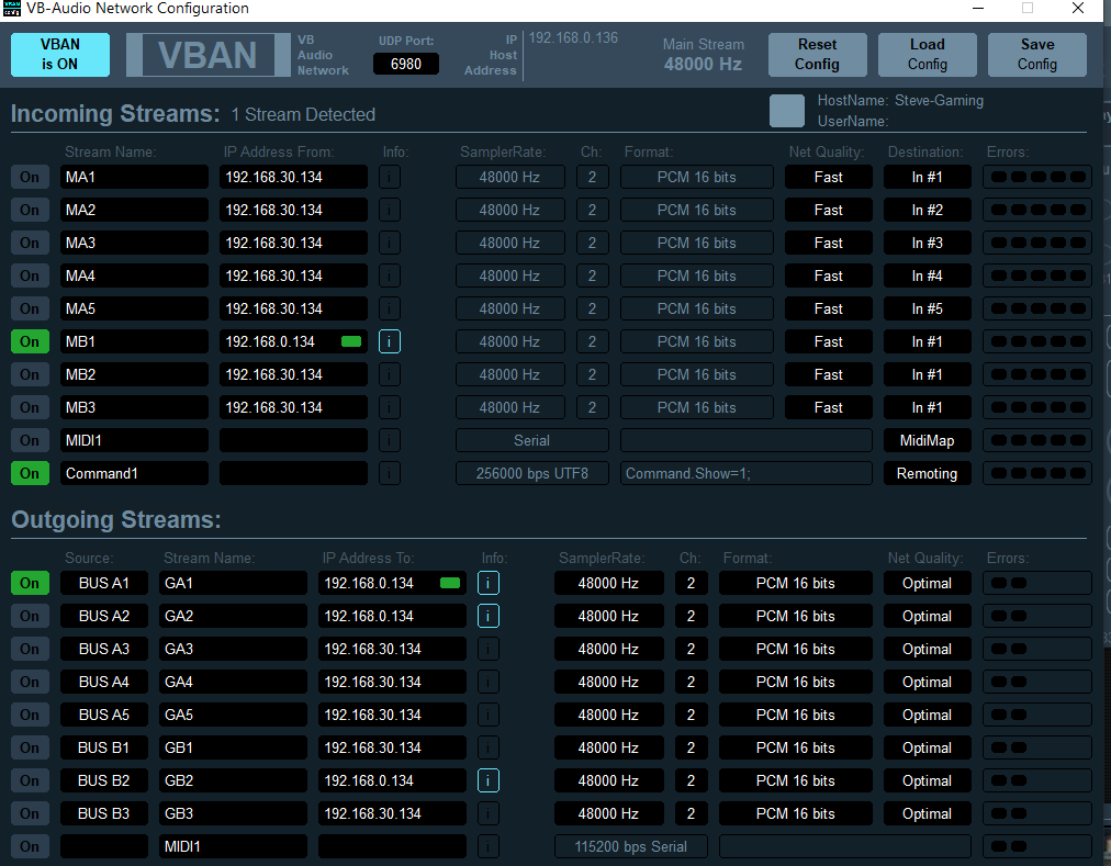

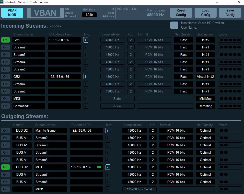

I cannot get incoming streams from my Gaming Computer to my Main Computer "Steve=HP-Pavillion". It just stopped working this morning. I upgraded both systems to VM 3.0.2.1 but the problem still persists.
Audio from my main computer works fine to my gaming computer.
I have everything set to default port of 6980
My main computer 192.168.1.134 incoming stream is called GA1 from 192.168.0.136 and I have it routed to In #5
My Gaming computer 192.168.1.136 outgonig stream is called GA1 going to my main computer at 192.168.0.134
I turned the firewall off and still nothing. There is a blue i box next to it that shows the ping is good.

I'm attaching screenshots. The first pic is the problem as I'm not getting any green bar on incoming. Again, this has worked for over a year and just failed starting yesterday.
Update: I also cannot even get text VBAN streams going from Gaming PC to main PC
Steve

then check Voicemeeter output A1 is working on PC 192.168.1.134
on PC. x.x.0.136, right click on info column to make appears the UDP port for outgoing stream, check it is 6980

A1 is working on PC 192.168.0.134. Since A1 was my UMC404 I even changed the config to my PC speakers to eliminate the possibility that my UMC404 driver is bad. It was a long shot because I haven't changed the Behringer UMC404 driver and I hear there are problems with newer versions of this driver. Right now it is my native Realtec driver. I also temporarily made A1 my Logitech headset driver to help eliminate that this was an A1 driver problem. Between each of these changes, I turned VBAN off and on again on both machines.
I also noticed that sending text via Macro button works from 134 to 136 but not the other way around.
Right clicking on the Info column on both machines shows that everything is port 6980. I have even tried changing the port numbers to see if for some reason something else was messing with port 6980 which might have caused issue.
I also cleared the unused entries on the incoming and outgoing streams so now only the streams I'm using have an IP address.
This issue is driving me nuts. Thanks again for your help!
