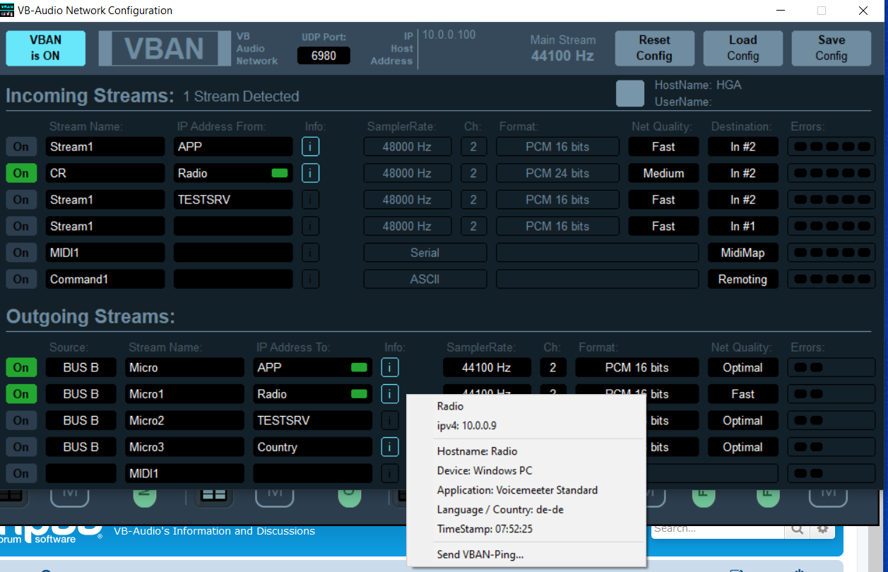

This is the computer which sends the outgoing streams
- This is the computer which sends the streams
- PC-VBAN2.png (233.17 KiB) Viewed 81692 times

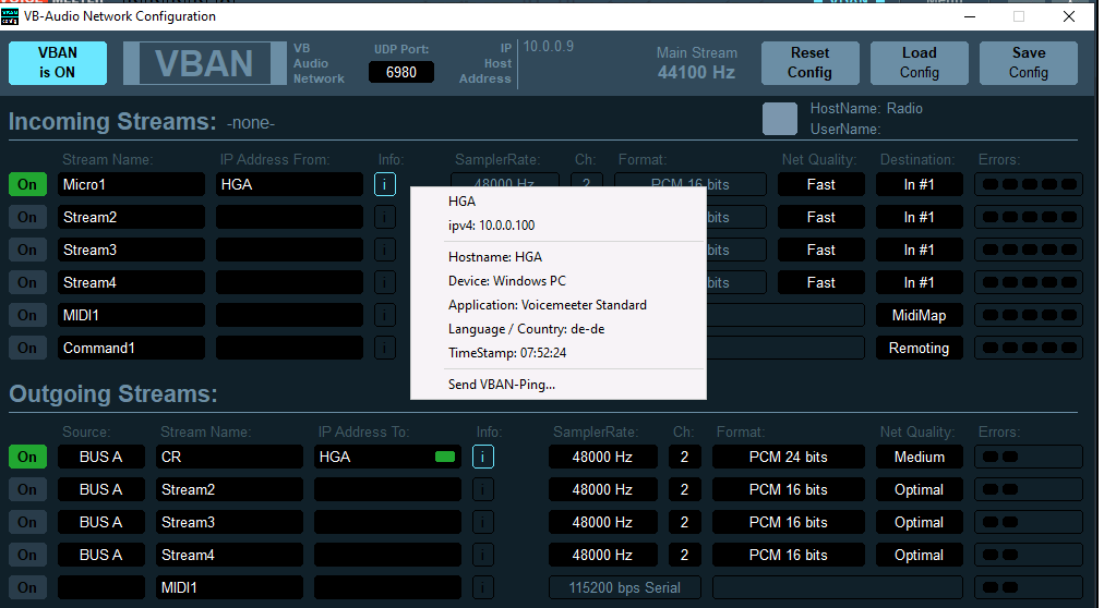

This is the computer, which cannot detect the incoming stream
- This is the computer which does not detect the incomming stream
- Radio-VBAN2.png (48.19 KiB) Viewed 81692 times

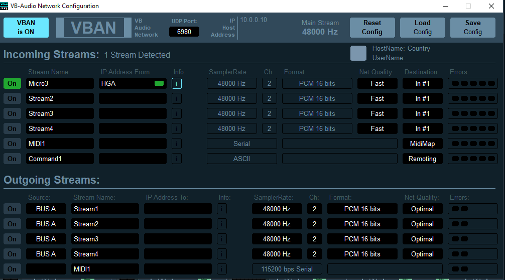

This is the computer which detect the incomming stream
- This is the computer which detect the incomming stream
- Country-VBAN.png (46.58 KiB) Viewed 81692 times
