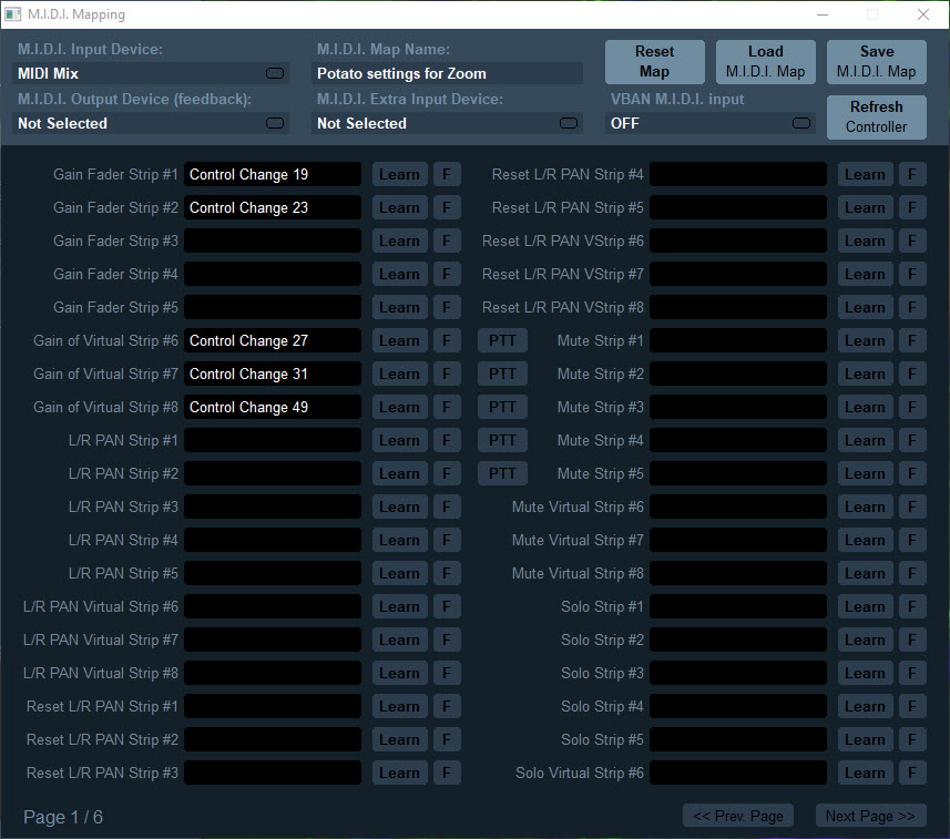

you may post a screenshot of your MIDI mapping dialog box, to let us see your MIDI device selection.

Posted: Sat Aug 27, 2022 12:04 am
by jonathan-g

When I first start Voicemeeter, after booting Windows, the "MIDI Mapping" dialog lists the control surface as connected (MIDI Input Device is set to "MIDI Mix" and MIDI Output Device is set to "Not selected" because I don't want feedback from Voicemeeter to the control surface), but moving the controls on the control surface doesn't have an effect on Voicemeeter.
