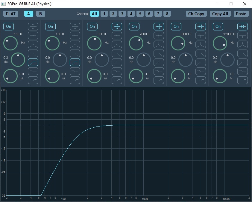

basically, if you need to apply equalization to your 7.1 speakers , you simply can use the Master EQ.
it's a 8 channel (independent) 6 band Full parametric Equalizer , that will let you adjust the sound of each channel as you want.
for example use one or more HPF filter to remove bass on desired speakers (channel):
