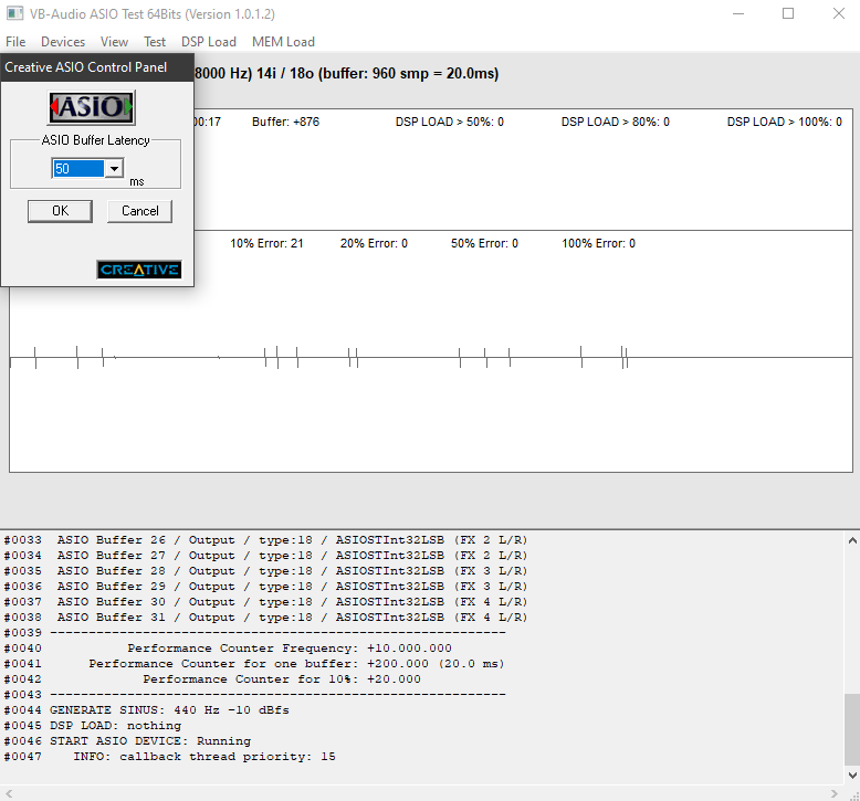

Thank you very much! As you can guess, I have an old Soundblaster Titanium HD that I bought over 10 years ago. :D
The "Creative ASIO ControlPanel" was displayed by the method you taught me. In the initial state, it was like 50ms.
I set it to 20ms and confirmed that VoicemeeterBanana started working properly.
ASIO Test.png (31.28 KiB) Viewed 28467 times

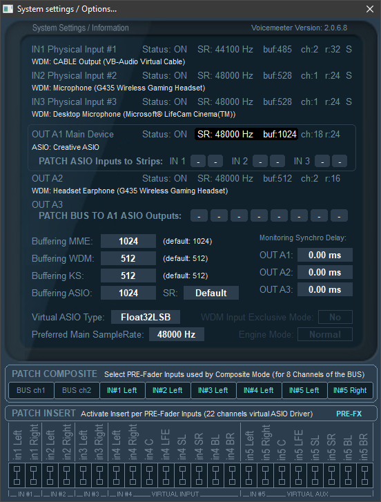

By the way, when I changed "Buffering ASIO" from Default to 1024 from the "System settings/Options..." menu of VoiceMeeterBanana, it seemed to work properly, but does this mean the same thing?
System settings.png (77.84 KiB) Viewed 28467 times

Re: How to fix "Failed to Open Main Output Device (A1) Buffer size cannot be above 2048 samples."?
Posted: Mon Jan 23, 2023 9:44 am
thanks for reporting feedback!
