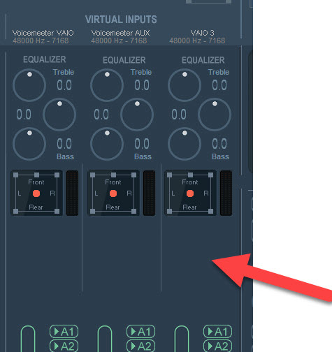

Yes, the virtual inputs were deactivated. I have activated them, but no sound comes in. For example, when I start a browser and run YOUTUBE, the programme is not assigned to a virtual input. So nothing comes out of the loudspeaker.
The microphone works, right. But otherwise, no sound source or programme (Spotify or browser).
It is strange that the "virtual output" appears under "input", as shown in the picture...

it's logical:
the Voicemeeter output is a recording device = a microphone (a windows input) in order to be used by application to capture the audio stream (coming from the related Voicemeeter output BUS).

VM is activated, so it is allowed to access the microphone. This is probably also the reason why the microphone was the only device that worked via VM. Before the "special" MS setup, it worked all perfectly. I am working with a German version of Windows 11 Prof 64 Bit.
But what irritates me is that when I start the browser or the Spotify desktop app or any other software, none of them is visible in the field with the red arrow. Although I have defined this input as the standard input...

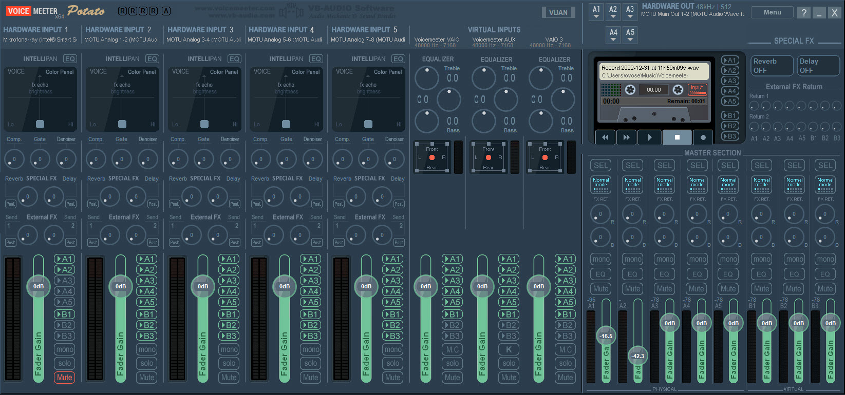

You know it's very difficult to help without seeing your entire configuration,
so you may at least post entire Voicemeeter screenshot (if not the same than above in previous message) and also the screenshot of your Voicemeeter System settings dialog box (see in Voicemeeter menu).

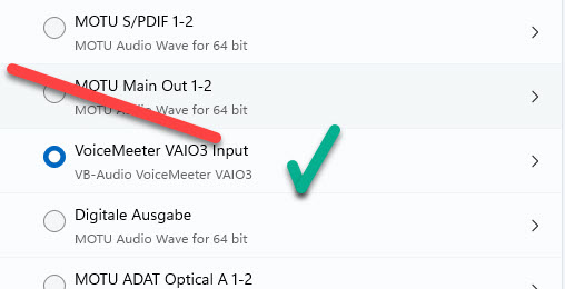

I have found the error! :shock: :o
I had selected the Main Out of the sound card as the output and not the Voicemeeter Input!
I changed the settings and now it works as desired.
