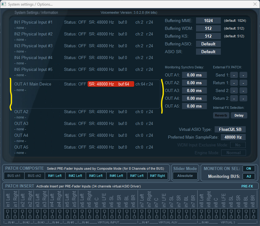

it does not work with the Clara E ASIO interface. If we use the ASIO interface of Clara E, VoiceMeeter does not connect
to the card:
- 'HARDWARE OUT' only shows a blinking 'Clara E',
- 'A1' disconnects 'ASIO: Clara E',
- In 'Menu->System settings' the string 'Status: OFF SR:48000Hz buf:32' in the line "OUT A1 Main Device: Status: OFF SR:48000Hz buf:32 ch64 r:24' is red,
- resetting audio engine and the like will not work,
- changing the 'buffer sizes' may (or may not) change the STATUS to ON if we stay in the settings dialog.

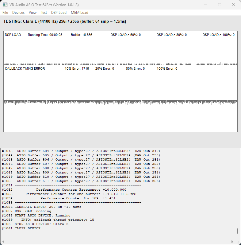

Searching the forum, we found 'VB-Audio ASIO Test'. The Clara E ASIO interface seems to work OK with this
tools. We can hear the output of the test sound generators through Dante VIA, if the sample buffer size is larger than
16. Here is an abbreviated output of 'VB-Audio ASIO Test 64Bits (Version 1.0.1.3)':

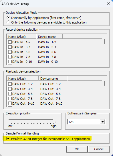

We enabled "Emulate 32-Bit Integer for incompatible ASIO applications" under the "Sample Format Handling" group in
the ASIO device setup of Clara E from within VB ASIO Test. We added screenshots for what we have done.
The change is visible in the output of ASIO Test. And the setting seems to be persistent over several program starts.
But the problem with VoiceMeeter Potatoe x64 3.0.2.8 is still persistent. No change at all.
Clara-E VB-Audio ASIO Test.png (50.26 KiB) Viewed 102719 times
Clara-E ASIO Setting-32-Bit-Int-compatibility.png (21.93 KiB) Viewed 102719 times
