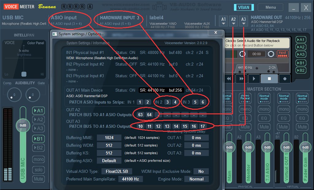

Posted: Wed Aug 24, 2016 6:18 pm
by RuudH
Hi Vincent,
It has been a while. I am picking picking up broadcasting again and i saw that there are some new features with assigning asio channels to other input strips. Now i am having a little trouble wrapping my head around this patching, and maybe it does not support at all what i intend to do.
I am using DJ software (Mixxx at the moment). i want to route the output to voicemeeter. Now the problem is that i can only select one asio device for main output and monitoring. So if i select Voicemeeter virtual asio I can select channel 1 and 2 for main and 3 and 4 for monitoring. But this will result in both main and monitoring comming into voicemeeter on the first virtual strip.
Would it be possible to "patch" channel 1 and 2 to one strip and channel 3 and 4 to another?
Thanks for your help!!
Re: Splitting ASIO channels
Posted: Fri Aug 26, 2016 7:34 am
hello,
With last VOICEMEETER, there is ASIO Routing capabilities for BUS A2 & A3 that can also be routed to output channels of the ASIO device selected for output A1. More information in user manual page 18: http://vb-audio.pagesperso-orange.fr/Vo ... anual.pdf
