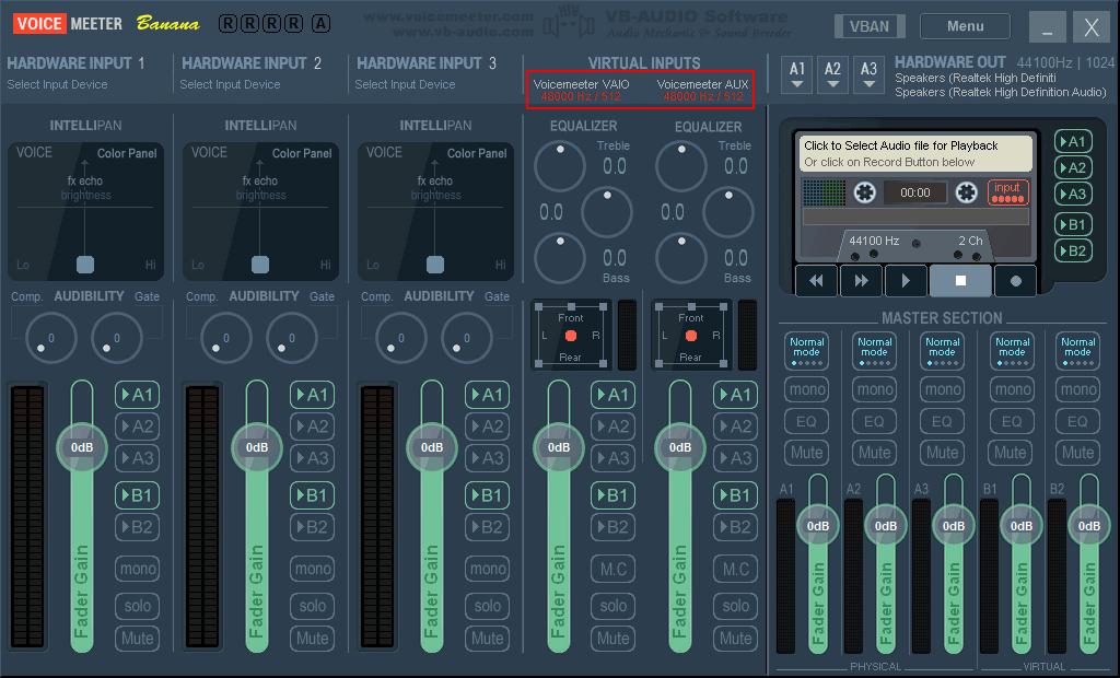

Everything was working fine and suddenly got the red info for the internal virtual inputs.
Uninstalled everything and only re-installed VB-CABLE A and Voicemeeter Banana.
When I start Voicemeeter I'm still getting the red info.
I used both control panels to set the sampling frequency for both at 48000kHz (run as admin).
Re: Red Info in Voicemeeter
Posted: Wed Jun 22, 2016 6:42 am
it is never necessary to re-install Voicemeeter. it's always a question of configuration.
The red display about buffering used by VAIO (internal latency of the Virtual audio I/O) is too small to work correctly
you have changed this value by VBCABLE_ControlPanel program located in Voicemeeter folder,
please set back the internal latency to 4096 or more to make it work again.
