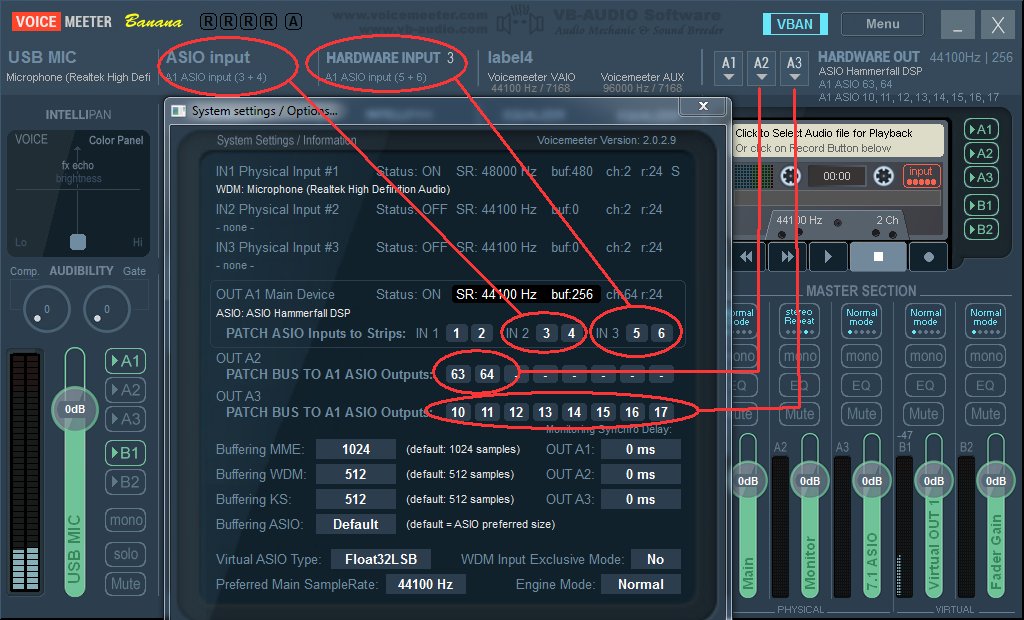

Here are 3 pics. I'll try uploading another 3 after...
Re: Intermittant interface failure during lessons.
Posted: Tue Oct 23, 2018 5:31 pm
by BSwishobne
Here are the other 3. I have also tried directing out from Skype to the AUX VAIO. All I get is a popping sound. The only sound that I can get to come out of either the VAIO or AUX VAIO is the midi sounds from Cantabile.

I changed the #1 input to MME and taught the first lesson with no dropouts. I did notice that when trying to use the WDM selection it did have the "S" to the right indicating that it was shared. I can't find any information in the Presonus forums describing how I can force the 44VSL and Universal Control into a non shared mode.

Posted: Mon Nov 05, 2018 8:23 pm
well, if you use an ASIO device connected to Voicemeeter output A1, you are not expected to use the this same device on other Voicemeeter physical input or output through MME, WDM or KS interface, because it can create conflict (audio device conflict).
you have different ASIO patch option in system settings dialog box to dispatch your ASIO device channels in Voicemeeter physical input and BUS...
see user manual page 20: ASIO Routing Capabilities
https://www.vb-audio.com/Voicemeeter/Vo ... Manual.pdf
