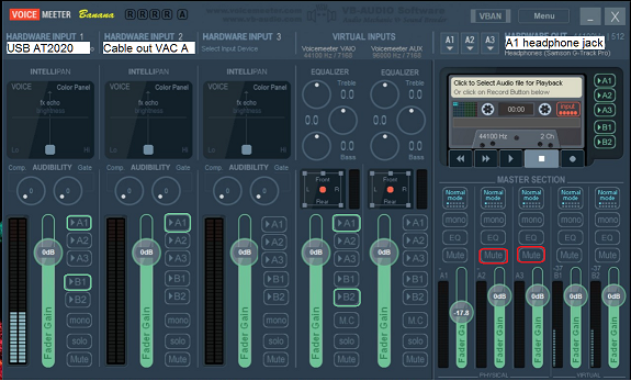

Using OBS Studio, i personally disable all of the devices under Settings/Audio. I create Sources for everything.
Setting up Voicemeeter like the picture below means you need to add the following sources for OBS, and copy them into every scene you want them.
Audio input Capture. VoiceMeeter Output (VB-Audio VoiceMeeter VAIO) < this captures bus B1 This is set up for your Mic
Audio input Capture. VoiceMeeter Aux Output (VB-Audio VoiceMeeter AUX VAIO) < this captures bus B2 This is setup for your default audio/game sounds/alert sounds from streamlabs or the like.
You will need to set the output for Stream Talk to CABLE-A Input (VB-Audio Cable A) this can either be done in the program if it allows, or withing windows 10 "App Volume and Device Preferences"
You can adjust how loud the TTS is for you by using the 2nd channel in VM.
If you turn on A1 on the first channel, the mic channel, you will hear yourself along with the game, no audio software is without latency however and you might notice your voice is a bit delayed in your headphones, this may be off putting and a bit detrimental, and you might want to turn it off after testing.
There is no exact way to mirror how loud your monitoring will be compared to what goes to the stream. If everything in VM is at 0(unity) it will pretty close. OBS encodes in a way that it might be just a bit softer overall than what you are hearing, also depending on your headphones and your motherboard jack it will be different than anyone else. They will adjust relative to each other however, so as you lower one or the other, the difference between them will be pretty much the same as perceived by your stream.
Let me know if this helps, i am more than willing to give you any more help you might need.
