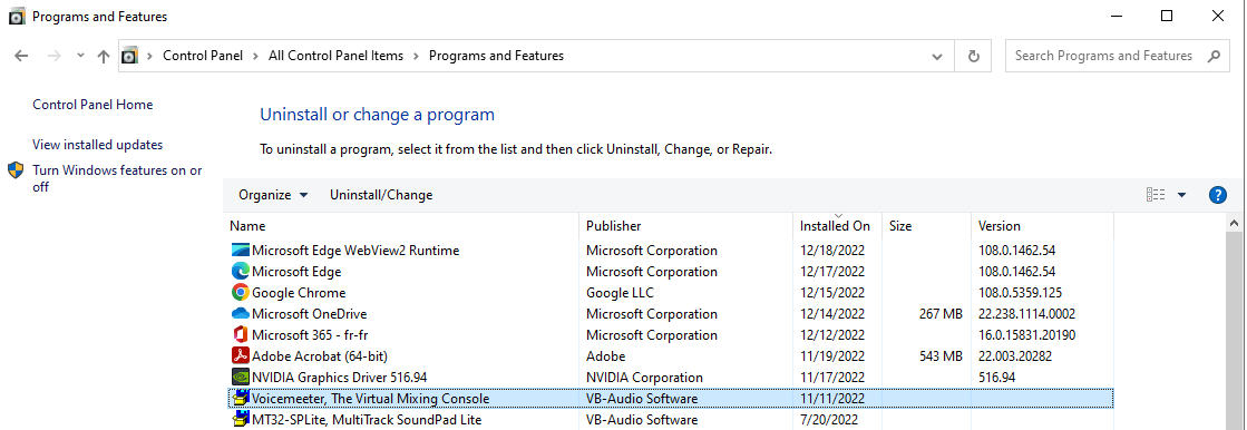

The best way to uninstall Voicemeeter is to use the uninstaller provided in Windows Control Panel / Programs and Features section:
Reboot after uninstallation!
if you made an uninstallation without REBOOT, re-installing Voicemeeter could not work anymore.

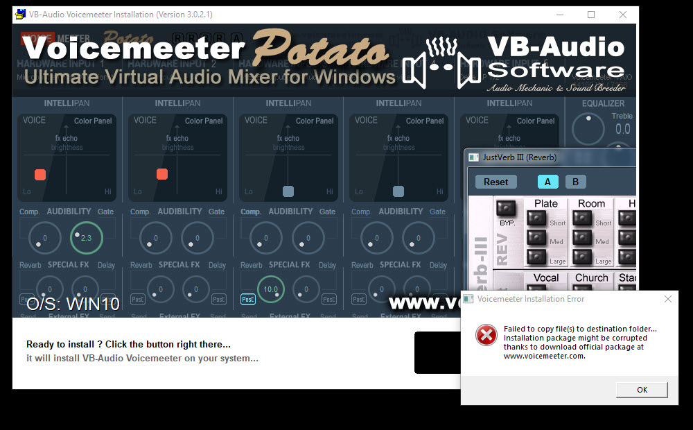

in case of Voicemeeter Installation Error: Failed to copy file(s) to destination folder...
This error usually occurs when an application is still using Voicemeeter services (VoicemeeterRemote.dll or Our virtual ASIO driver), so the solution is to close all applications that could use Voicemeeter services.

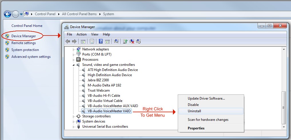

If Voicemeeter Setup Program does not propose you to install, it’s because virtual audio device (or part of them) are still installed or not completely uninstalled. You need to uninstall Voicemeeter Virtual Audio Driver manually by the Windows Procedure:
(1)- Go in system / device manager
(2)- Find any reference to Voicemeeter Audio Device and click on it to uninstall it.
(3)- Check first in Sound Video Game controller section, then after check in audio inputs and outputs section.
(4)- Reboot after each operation.
REM: Start by uninstalling multimedia drivers (not audio I/O)
When the multimedia driver is not present anymore,
You might uninstall remaining Voicemeeter audio i/o if any
Reboot and Repeat the operation until having no more Voicemeeter audio component on your system.
if nothing works and you still can't install Voicemeeter again
Check in Windows Device Manager again! If you uninstall audio I/O only, the controller will reinstall them on next reboot. So you may first uninstall Voicemeeter VAIO device listed in "Sound, Video and Game Controllers" section.
then after reboot, if nothing is present in "Sound, Video and Game Controllers" section. You may unsinstall remaining Voicemeeter I/O in "audio I/O" section.
