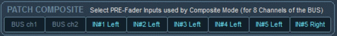

Hi. Try this setup:
  • Select one USB microphone in Hardware Input 1 (WDM should work). In Hardware Input 2 select the second USB microphone.
  • Check the volume level meter bar for hardware input 1 and 2: USB microphones typically are stereo devices so both channels (Left and Right) should be visible.
  • Turn on B1 on both hardware input 1 and 2: This routes the 2 microphones to the B1 output bus. Note that B1 output bus is connected to the VoiceMeeter Virtual ASIO output device (It will be used in Reaper)
  • In the master section, locate the B1 bus and change its routing mode to Composite by clicking repeatedly the button located under the SEL button. It should be initially labeled Normal mode
  • Select System Settings / Options... from the Menu. Locate the PATCH COMPOSITE:
    patch composite.PNG (142.31 KiB) Viewed 22442 times
    Click over the text that reads Select PRE-Fader. It should change to POST-Fader
  • Select IN#1 left in the first box (leftmost). Select IN#1 Right in the next one (These are the 2 channels from your first microphone). Select IN#2 Left in the third and IN#2 Right in the fourth (These are the 2 channels from your second microphone)

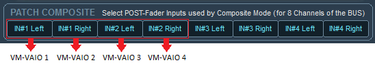

So, that got me most of the way there. One of the mics is now working as intended, but the other is still going to both tracks and I don't know why.
I've grabbed a screen shot of all the things I think might be relevant to try and make this easier.
https://imgur.com/b33Cily
Re: Two Mics, Two tracks
Hi. Please use the following PATCH COMPOSITE settings:
patch composite.png (6.83 KiB) Viewed 22412 times
Channels 1 and 2 are connected to Hardware Input 1 (Left and Right)
Channels 3 and 4 are connected to Hardware Input 2 (Left and Right)
Post by sailorbrendan »
THANK YOU!!!!
that made it work. You're an absolute legend.
