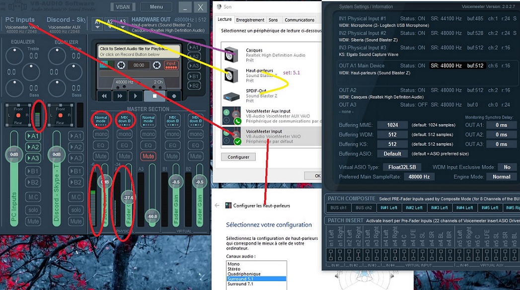

Hi, test with it:
Inside Windows Audio Panel:
Set the configuration to 5.1 in Voicemeeter VAIO to 5.1 and set this output as default.
Inside Voicemeeter Banana:
Set the Digital audio output to A1 as normal mode.
Set the Stereo audio output to A2 as Mix Down B.
Test with a 5.1 source in DD or DTS. You must see 5 monitoring lines moving with the sound under Voicemeeter VAIO AND A1. A2 must have only 2 lines.
PS: By default, Windows use pcm 2.0 audio stream on digital output. So Make sur your source is sending 5.1 signal.
PS2: For permanent 5.1, you need an encoding like DD Live or DTS Connect or a third party app. In my case, my PCIE soundcard do the job with a redirection -> the yellow curve.
Check inside your soundcard driver app or manual for further information and how to use your digital output if necessary.
Sans titre.jpg (251.63 KiB) Viewed 56310 times
