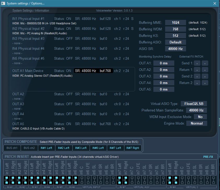

If the problem remains, send a screenshot of Voicemeeter and its system settings dialog box to let us see your configuration.

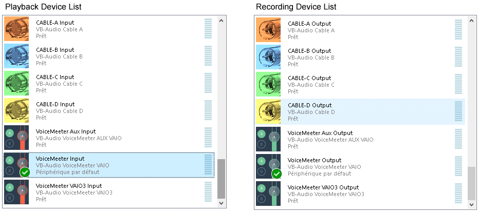

Anyway your VB-CABLE or Voicemeeter VAIO's must appear like on the picture below for Playback and Recording Devices. Otherwise you should re-install them correctly.

To let us take a serious look on your problem, you may post screenshot of
- Voicemeeter
- Voicemeeter System settings dialog box-
- VBCABLE Control panel of Voicemeeter VAIO used by Discord.
and also:
- Discord audio settings Dialog box.
- Windows playback device list (showing default playback device and default comunication device)
- Windows recording device list (showing default recording device and default comunication device)

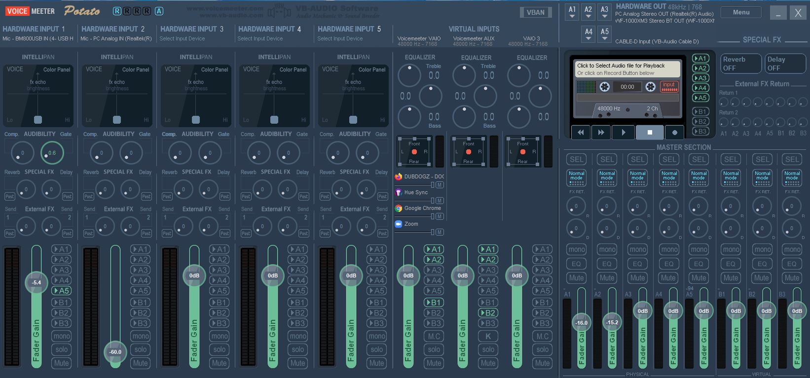

Screenshots:
So the question is: What Am I doing wrong?

Here comes my screenshots, Vincent. I think that's about it... phew.
