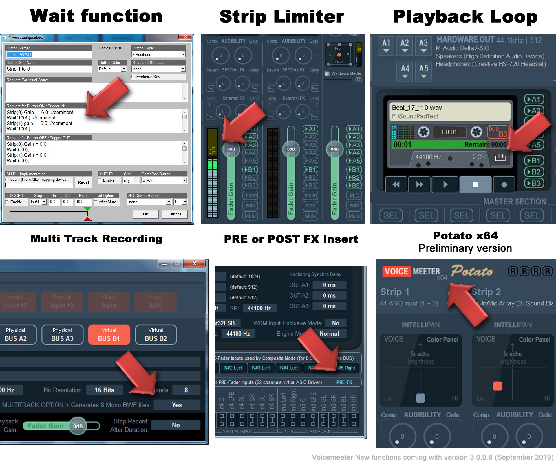

Correction / new functions 3.0.1.0 / 2.0.5.0 / 1.0.7.0
QUALIFICATION : RELEASE.
-MacroButtons: Trigger or Winput options could not be set or removed on button without keyboard shortcut.
-MacroButtons: implements DMX functions to control DMX 512 Light Network
-REMOTING: with relative value could not work correct with limit and gainlayer. New functions: patch.PostFaderComposite, patch.PostFxInsert, option.ASIOsr allow settings last options added in System Settings Dialog box.
Correction / new functions 3.0.0.9 / 2.0.4.9 / 1.0.6.9
-INTEGRATED PLAYER: Bug correction related to end of playback at end of Sound. Implementation of the LOOP option to repeat the sound indefinitely.
-STRIP LIMITER on Voicemeeter Banana & Potato can be managed by clicking on the meter bar of each strip and allow limiting strip level to any threshold from -40 to +12 dB (before Gain Slider).
-VOICEMEETER REMOTE: implementation of different possible missing instructions like Recorder A4, A5, B3 buttons. Bug Correction on different recorder parameters read operation (mode & samplerate for example). Implementation of the new LOOP option and Strip(n).Limit Parameter.
-MACRO BUTTONS: Wait(ms) instruction allows to introduce timing in the script to finally build a sequence of requests.
-MACRO BUTTONS: System.Execute function implements ENV VAR management inside percent char (e.g. %VARNAME%). This percent char is now used to code double quotes char (“) by the sequence %’ (percent + quote) and simple percent char (%) by the sequence %% (double percent).
-VOICEMEETER SYSTEM TRAY icon / menu now contain the “Restart Audio Engine” function and the SHOW at default position command for people having lost Voicemeeter Display.
-WINDOWS Position: checking that is in a active display monitor for Voicemeeter, MacroButton, GEQ15 and MATRIX 8x8
-RECORDER OPTION: Target Directory Selector now displays the current directory when opening the browser dialog box. MULTITRACK OPTION allows generating multiple mono files (one file per track) – up to 8 tracks if recording a BUS -.
-SYSTEM SETTINGS: PATCH INSERT can be set PRE-FX (per default) or (POST-FX) by clicking on PRE-FX part on top-right of the Virtual PATCH Insert section. INSERT ASIO Driver is 22 channels for Voicemeeter Banana, 34 Channels for Voicemeeter Potato.
-REVERB: Potential Crash when delay was set above 950 ms (not enough memory allocated).

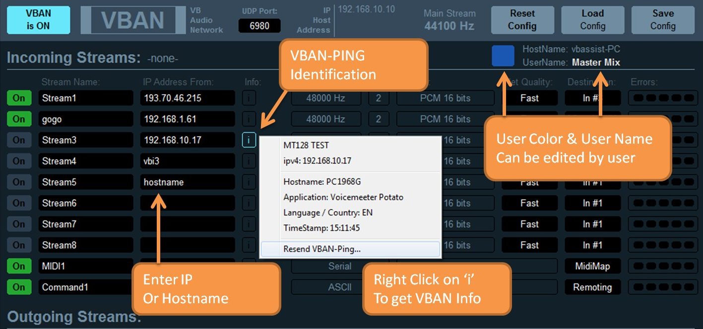

Correction / new functions 3.0.1.4 / 2.0.5.4 / 1.0.7.4
1-POTATO: remote instructions to change Strip & Bus LABEL were not fully implemented. VAIO3 Label could not be displayed correctly if reset to empty string.
2-ABOUT: Revision of the Challenge code generation to fix possible unexpected change (e.g. on Windows Update). Possibility to import/export the computer footprint to guarantee to be able to use the same activation code after windows re-installation on the same PC.
3-VIRTUAL ASIO: was limited to 96kHz, now support up to 192 kHz.
4-COMPOSITE MODE in Voicemeeter Standard was not working properly, channel 3,4 were empty.
5-VBAN Dialog: IP Host Address list was not refreshed when restarting VBAN services. Now, restarting VBAN will display possible new IP Address (from other network adapter or due to DHCP re-negotiation).
6-VBAN outgoing stream tested and validated with high bitrate (like 384 kHz 32bits) without send error.
7-VBAN IP Address can be defined by HostName instead of IP address. The local hostname is displayed in the top-right of the VBAN Dialog box, above the username (that also can be defined by user). A Color can also be edited by user as additional visual identification.
8-VBAN-INFO column (replacing UDP port – now globally defined in the VBAN dialog box caption) will display different information. ‘I’ shows the identified IP address (VBAN-PING). Left Click to RE-PING, Right Click to get info on unit behind the IP-Address or Hostname.
9-VB-Audio Logo in the middle of the Voicemeeter caption does not open an URL anymore. This area can now be used to grab the user interface and move it.
10-MENU : “System tray” option is now different from the “Run at Startup” option and can be set independently.
11-POTATO: SEL Button state is now saved in configuration file.
12-MACRO Buttons: Button(n).Trigger = 0/1 instruction allows to enable / disable the audio trigger process on a given button.
13-MACRO Buttons:Load function now should take ENV VARIABLE into account in the string.
14-VOICEMEETER MENU: Lock Graphic User Interface option allows to disable main user interface to avoid unwanted ctl change by mouse. A LOCK icon is displayed left to the VBAN button.
15-Voicemeeter Standard: The [A] icon on top left was not displaying connected client applications to Voicemeeter Audio API.
16-MAcroButton XML file XML possible error in first tag <MacroButtonConfiguration … > that should not finish by /> (potential problem for XML editor, but not for MacroButton application).
17-Voicemeeter Standard & Banana , possible XML error in <OptionDev srasio=’%i > tag.
18-REMOTE API: New functions to manage MacroButtons States, and VBAN instructions too: “Button(i).State = 1 or 0”, “Button(i).StateOnly”, “Button(i).Trigger”.
19-VBAN-CHAT: Right Click on VBAN logo opens the VBAN-CHAT Dialog box to chat with any connected VBAN device.
20-RECORDER: REC Button appears as PAUSE button when recording to suggest this same button can be used to PAUSE and RESTART the recording. The PAUSE status is also now existing in Voicemeeter Remote API.
21-MENU: Load File On Startup allows selecting a file to be loaded on Voicemeeter startup. Hook and Run items are now placed in submenu to reduce the main menu height.

1- VBAN UDP PORT: displayed in red in case of use by another application (a warning dialog box is also displayed).
2- VBAN IP HOST ADDRESS could not display all Ethernet adapters type (some WIFI adapters cannot be listed).

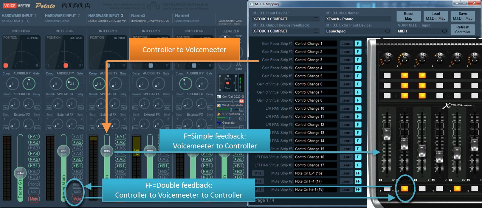

3- MIDI mapping: control list has been re-arranged and user can now define a secondary input device (for a secondary MIDI controller) Left-Right PAN control has been added. 4 first applications connected to 3 virtual inputs can now be controlled by MIDI (volume and Mute).
4- MIDI mapping: a MIDI output device can be defined to send feedback to the Input MIDI device (‘F’ button activate the feedback process for each control ‘FF’ for double feedback).
5- VBAN MIDI Out Stream has been added to outgoing stream list to send MIDI Feedback or forward other MIDI streams through the VBAN network.
6- VBAN: UDP PORT per stream can be configured again by right click in the info zone to switch the display to individual UDP PORT or coming back to INFO (Ping = ‘i’).

- VoicemeeterMIDIFeedback.jpg (253.04 KiB) Viewed 324902 times

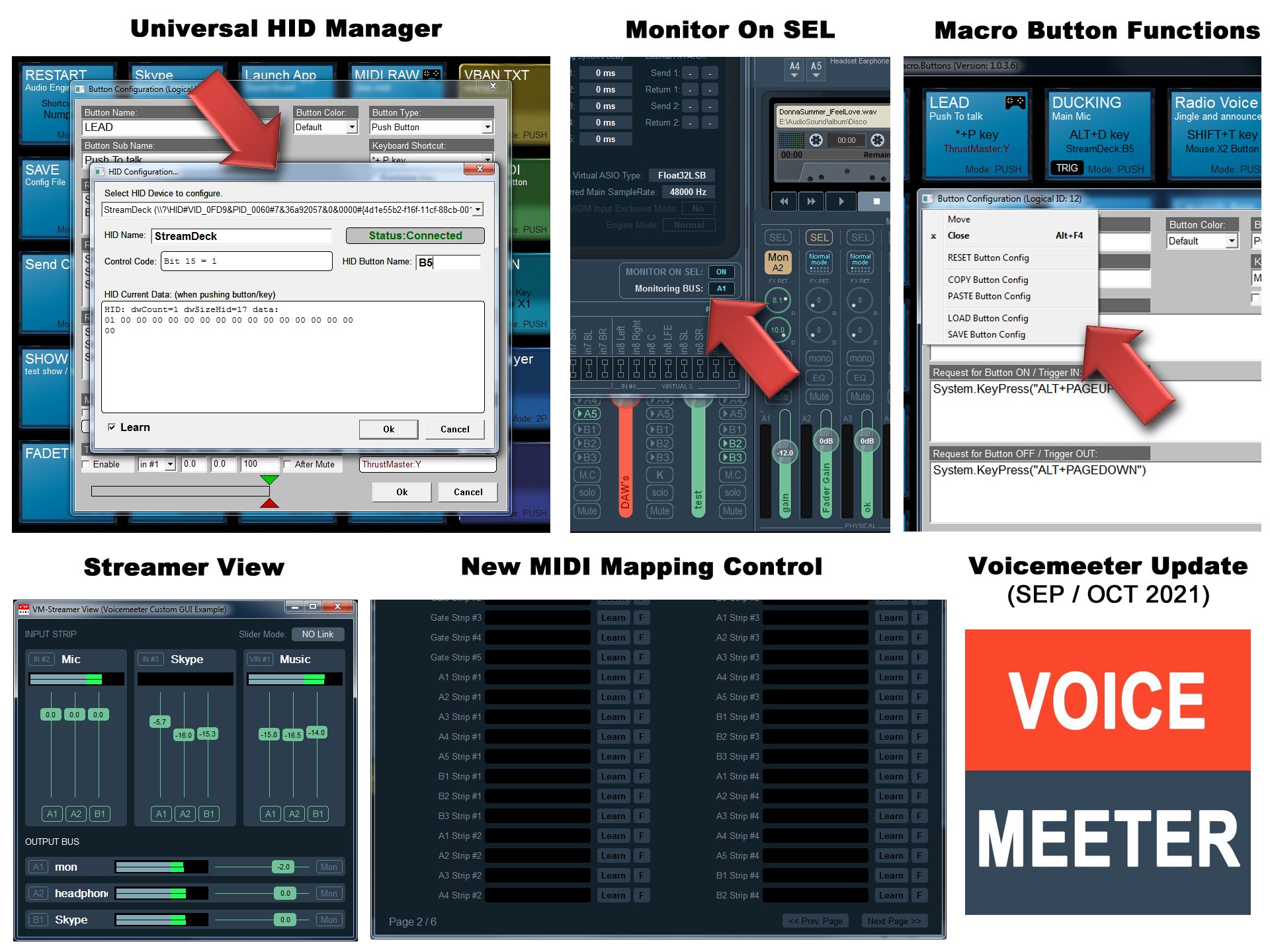

4-MIDI MAPPING: add PAN Reset Control to reset the panoramic with a MIDI button.
5-MIDI MAPPING: Display in orange the MIDI code if already used for another parameter. Right Click on code field to get popup menu with the first found occurrence. Then you can click on it to go on its page.

1-STREAMER VIEW: Strip Mute was not working to set MUTE state from the Streamer View. MON button must be shown only for Potato (BUS Monitoring option is available only on Potato). BUS Peak meters now display max peak.
2-VOICEMEETER VBAN: new service: RT Packet allows to client application to receive Real Time data from Voicemeeter (Levels and parameters).
3-STREAMER VIEW: VBAN implementation (thanks to VBAN RT-Packet Service) to use the Streamer view as a distant controller on a one or several computer of the network (up to 8 clients supported by Voicemeeter RT-Packet Service).
4-ABOUT BOX: License Activation e-mail was limited to 60x char because the EDIT Control was not set in AUTOSCROLL mode.
5-MacroButton: check compatibility between HID Keyboard and Regular Keyboard messages. HID Device list with friendly name is now stored in USER registry. General HID management Revision.
6-MacroButton: New command Show(0/1) to Hide/Show the MacroButtons Application.

14-MACROBUTTONS: add functions in system menu of the button configuration dialog box to: Reset / Copy / Paste / Load / Save a button configuration.
15-MIDI MAPPING: add Bus Assignation button for all Strips. MIDI Feedback was not working on Voicemeeter Standard.

21-MACROBUTTON: HID Universal management to learn any kind of HID device. REM using Keyboard HID device could disturb the regular Keyboard management in MacroButton, meaning you may have to choose between regular or HID management on a Button Map.

- VoicemeeterUpdateSEP2021.jpg (472.91 KiB) Viewed 309503 times

10- SYSTEM SETTINGS: Slider Mode allows to define a RELATIVE mode behavior for the slider sub-mix (to get a consistent MIDI control behavior with the VM-Streamer View as well). VBAN Related instruction is also implemented: Option.SliderMode = 0 or 1 (1= relative).
11- STREAMER:VIEW: Slider Mode simplified with a notion of master slider: The first slider is controlling others in absolute or relative mode. RelativeMode is also working consistent with the instruction FadeBy(). Mouse Wheel Implementation.
