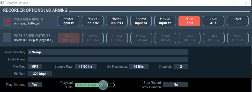

user4711
Posts: 20
Joined: Wed Jan 02, 2019 6:57 pm
Re: How can with the voicemeeter tape recorder record without the insert disable ?
Post by user4711 »
maybe you can do a example preference that work in this situation.
see screenshot i attach. I thought when i record on earliest connection possible (pre fader) then the signal is send to recorder before it is send to insert.
recorder inputs.jpg (132.49 KiB) Viewed 23890 times
JBP
Posts: 73
Joined: Sun Dec 16, 2018 3:03 am
Post by JBP »
@ user4711
My previous post was meant for Vincent Burel to accept that the PRE-FADER does not work correctly, not for you user4711!
Virtual Input is not the way!
You are using your microphone with Hardware Input 1 and Patch Insert (ASIO) as speaker correction (and it works).
Normally (in theory) using PRE-FADER INPUTS and Physical Input #1 is the way to record it without the Patch Insert (ASIO) or the more complicated method with Patch Composite that Vincent has described.
The problem is, it does not work, because PRE-FADER definition is corrupted (it includes the Patch Insert plus other FX).
It is a bug!
I wait for Vincent Burel to agree on that fact, before I post the workaround.
