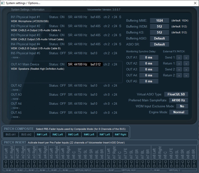

I have not touched the VB-CABLE internal latency. The only things I have done are in the mentioned Youtube link. The attached image to this message should show the current System Settings.

everything seems to be correct in your configuration.
i guess your game is conencted to first virtual input (that you call "Desktop")...
this Voicemeeter virtual input is well configured with 7168 samples buffer size...

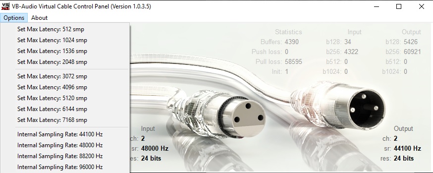

for the case #2 you can open the related VBCABLE_ControlPanel (in Voicemeeter folder) to change the internal max latency to 16k for example... then reboot and set the internal latency also to 16k... then see if the audio game comes in...

I have tried testing without exclusive mode first, then with it, and now once again without it. It seemed to make no difference towards the situation I am in. The internal latency in VBCABLE_ControlPanel appears only to go up to 7168 smp, not 16K as you mentioned.
I've tried reducing it to 2048, as well as 4096 in the Cable's Control Panel, and then the 'Desktop' sample rate to match that however the issue remains.

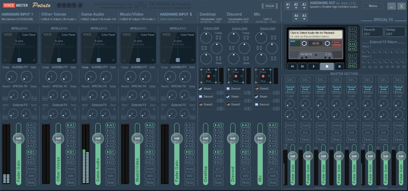

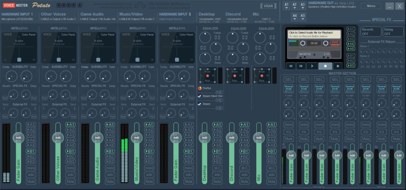

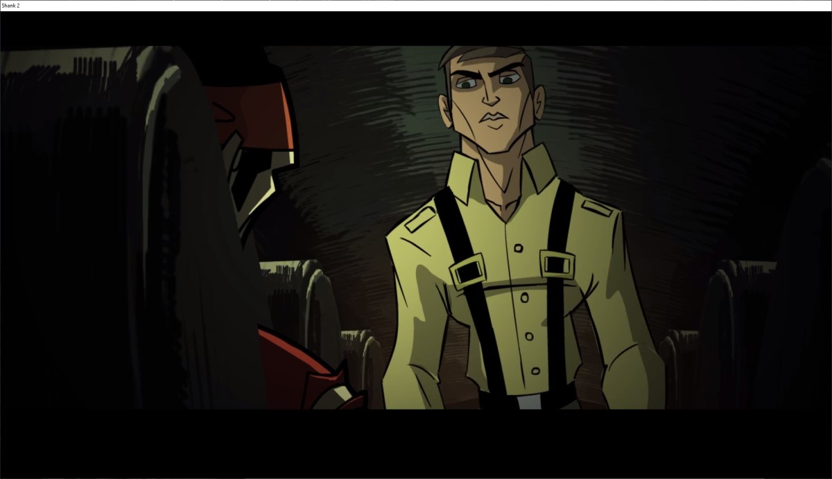

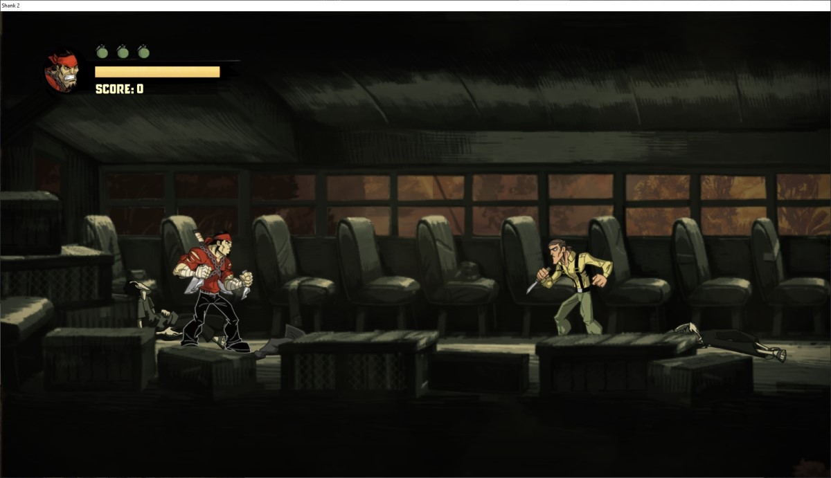

Below are images of VoiceMeeter reading the game audio initially during the cut scene, and then follow up screenshots of the audio cut out with the game transitioning from the cut scene. The audio system and game running in the above images are working correctly.
lzygmr
- Posts: 7
- Joined: Wed Jun 12, 2019 1:13 pm
Re: Game Audio Stops Being Read By Voicemeeter

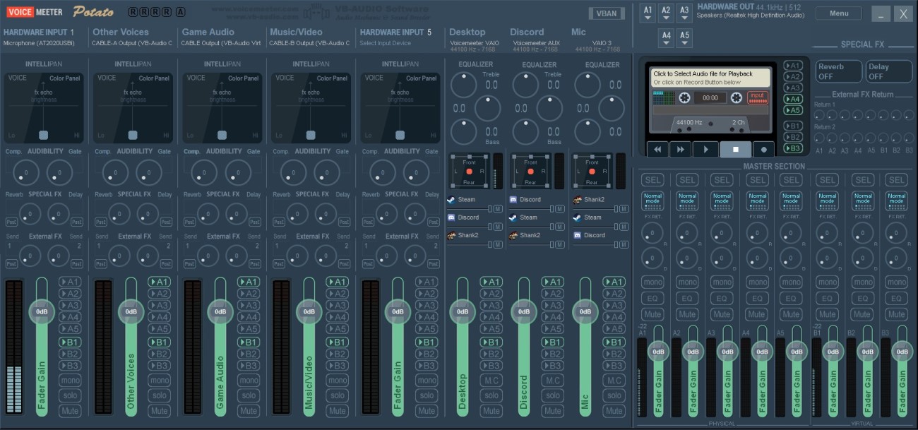

Below are screenshots of the game and audio after the cut scene. The audio is cut out from the 'Game Audio' channel, however is still coming through my headphones and can be seen still affecting the audio output of A1 in the Master Section.

Your game is not playing back in the VB-CABLE but in the first Voicemeeter virtual input (these are different virtual audio device). Please run the VBCABLE_ControlPanel related to this Virtual I/O. This program is located in Voicemeeter folder (in your start menu or in your program files folder).lzygmr wrote:The internal latency in VBCABLE_ControlPanel appears only to go up to 7168 smp, not 16K as you mentioned.
REM: Don't set the internal latency below 7168 samples on VB-CABLE.
