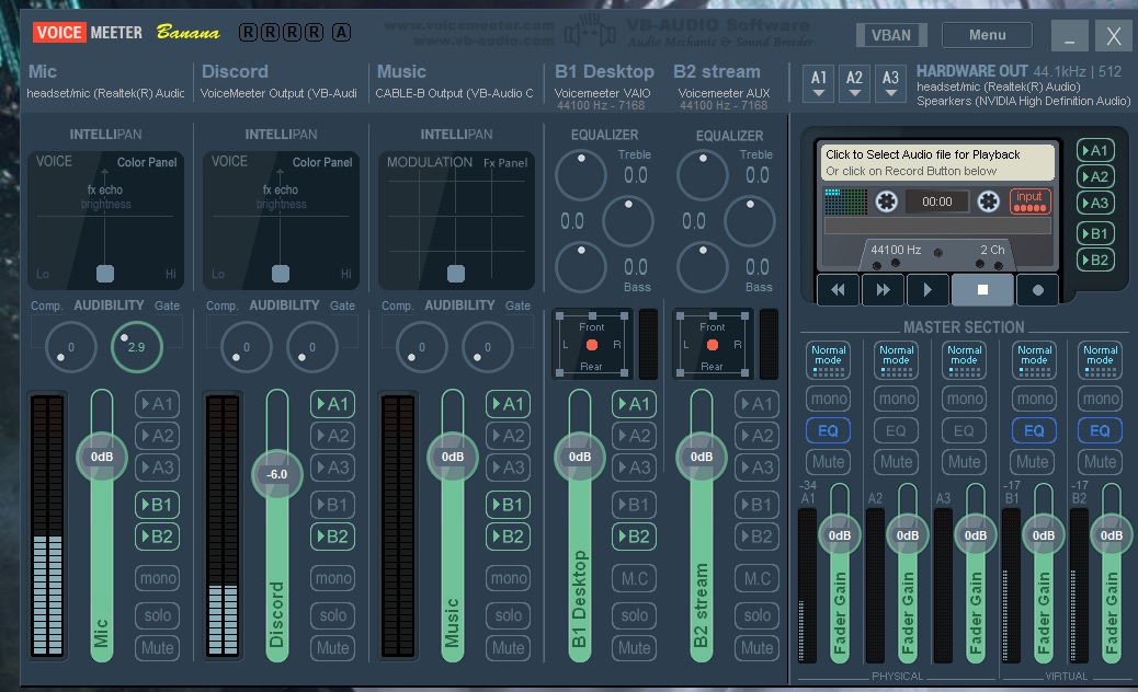

So what I am trying to do is have music play from my pc into discord. My gf is telling that the music I play sounds choppy is this do to the fact that is being layered mult times from pc > driver > voicemeeter > and then discord???
and or some kind of latency
this is my set up
this is my set up
voicemeeter pc.jpg (209.44 KiB) Viewed 6185 times

if the problem is only on the music, you may check your connection through the VB-CABLE B
you may check that VB-CABLE B internal latency is 7168 sample (by its controlpanel app)
and you can try to use another interface to connect it to voicemeter (MME for example)...
