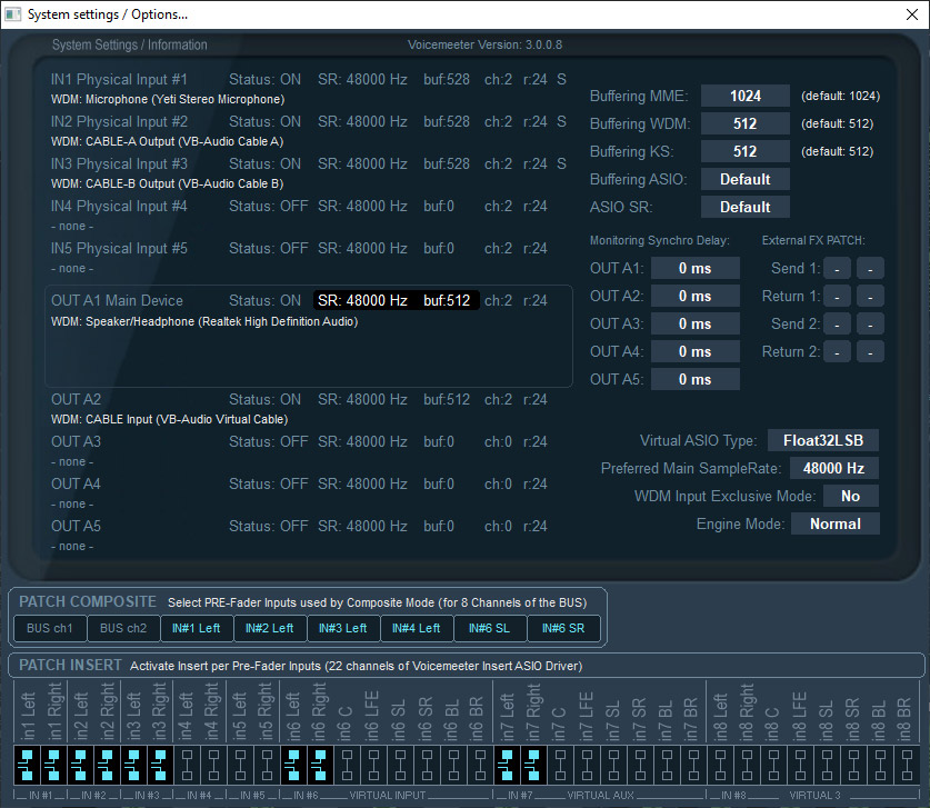

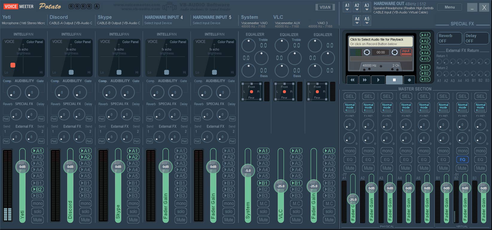

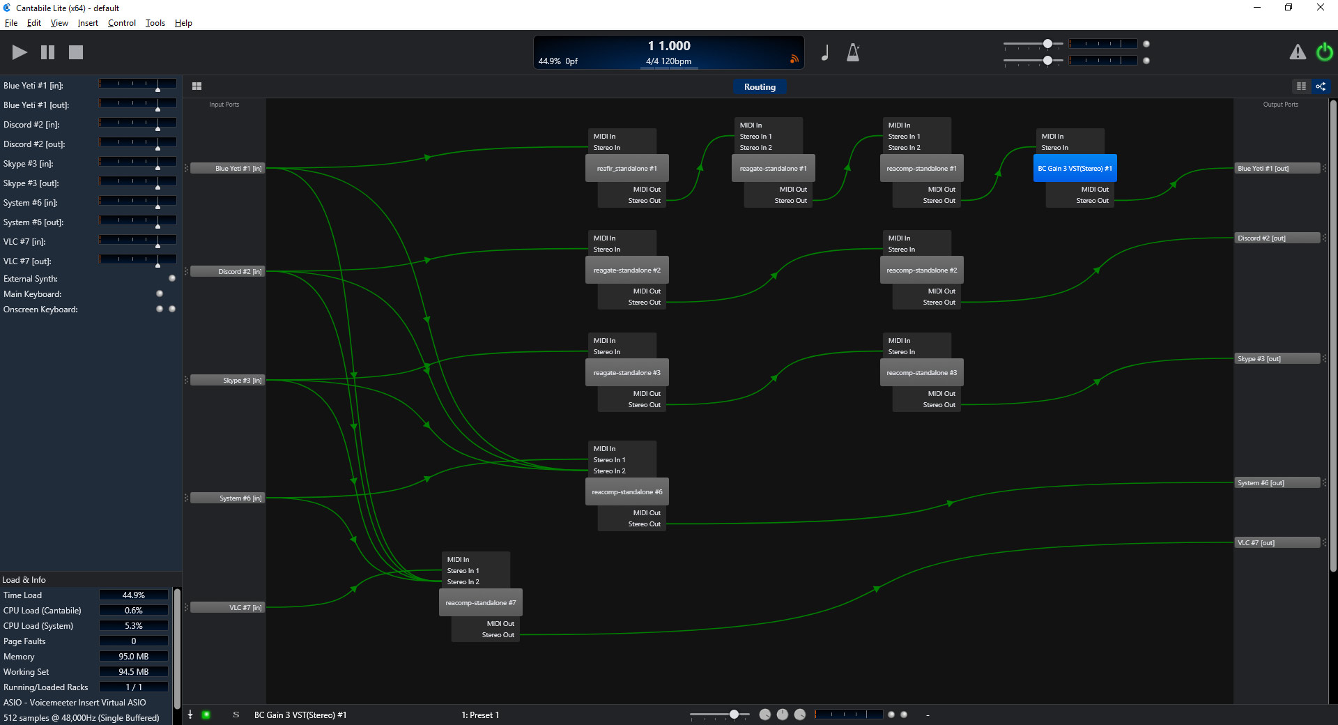

I have used Voicemeeter Banana with Cantabile 3 without issue for some time.
I am trying VB Potato - the installation went fine and I have been able to get the mic working.
However, my inputs of Discord, Skype, Music & System no longer work while Cantabile is active.
Cantabile reports that all connects and plugins are connected correctly, and if I switch to Banana, indeed they work - changing from Voicemeeter Potato Insert Virtual ASIO to Voicemeeter Insert Virtual ASIO, but they will not work through Potato.
I have made the appropriate changes due to the extra hardware channels, but this does not explain the issues occurring on the channels that are not affected by the increase.
Thank you in advance for your assistance.

did you really check that CANTABILE is connected to Virtual Potato ASIO Insert Driver (not Virtual ASIO insert for Banana) ?
