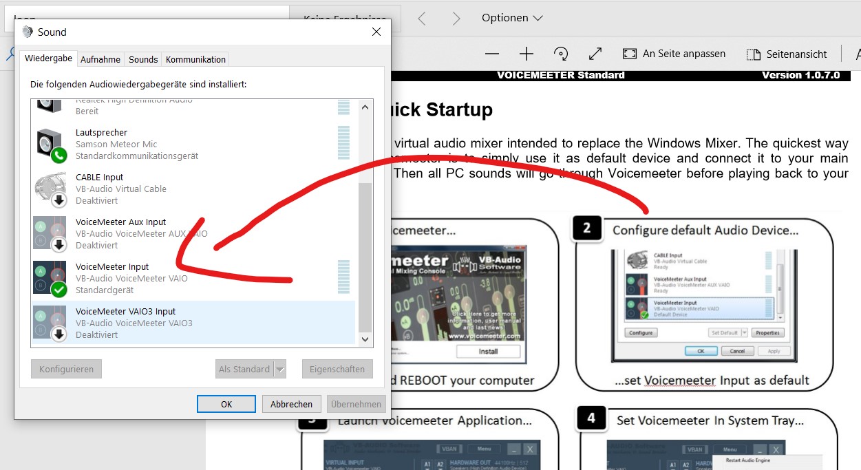

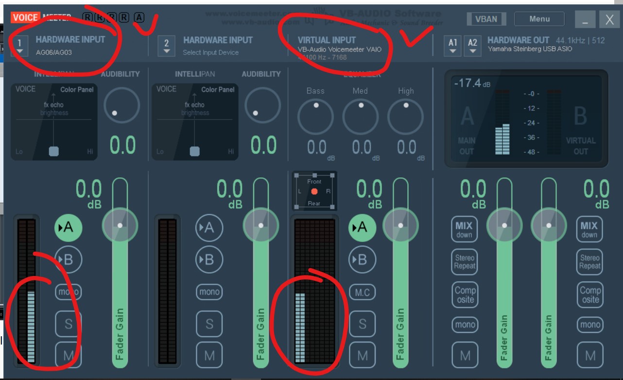

2. Sound in Voicemeeter
Anmerkung 2020-03-09 133914.jpg (160.9 KiB) Viewed 22031 times

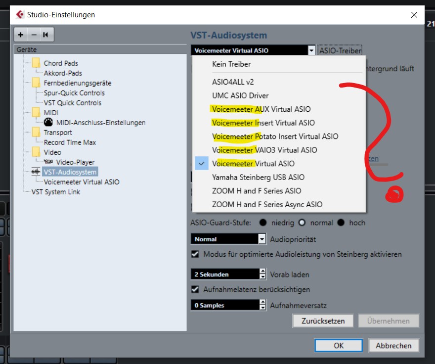

3.Whatever VM driver I use - no sound in Cubase:
Anmerkung 2020-03-09 134149.jpg (106.15 KiB) Viewed 22031 times
(BTW, which one is correct for VM Standard?)

"Voicemeeter Virtual ASIO" is the virtual ASIO driver for the first virtual input of Voicemeeter (and BUS B).

Thank You. That helped. :)
When I switched to "BUS B", I have sounds coming to Cubase.

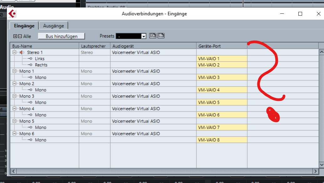

But what get's me puzzled is the view of Voicemeeter from inside Cubase.
F.e. I don't get the buses Cubase offers me linked to the Voicemeeter side.
Anmerkung 2020-03-09 165254.jpg (119.4 KiB) Viewed 22022 times

Voicemeeter virtual input is able to manage up to 8 channel (to get 7.1 from DVD player for example)
so the related virtual ASIO driver is also providing 8 channels. You can see that on the Voicemeeter virtual input VU-meter if you send audio from Cubase to channel 3,4,5,... 8
For what you want to do , you may use Voicemeeter Banana version instead...
also you may read user manual page 15,16 and 20 at least to understand the virtual I/O of Voicemeeter
https://www.vb-audio.com/Voicemeeter/Vo ... Manual.pdf

I think ( also reading the other thread - > viewtopic.php?f=6&t=977 ) you are confusing VB drivers and the related busses with channels. There are 3 VAIO (ASIO) drivers with I/O each with 8 input channels and 8 output channels. Additional you have 2 ASIO insert drivers.
The insert drivers are meant for processing Voicemeeter inputs with external FX (VST plugins in a DAW or any other VST host app). In Potato you have 5 hardware inputs and 3 virtual inputs (VAIOs). Each hardware input has 2 channels, but every virtual input has 8 channels (5x2 + 3x8 = 34 Potato insert channels or 3x2 + 2x8 = 22 Banana insert channels).
For regular sending and receiving (recording) audio with a single DAW you use one of the three (non-insert!) VAIO drivers. If you want to send multiple voicemeeter inputs to individual tracks/mixer channels of your DAW you have to use Patch Composite bus output option in VM Banana or VM Potato. You can assign any of the 34 (Potato) or the 22 (Banana) input channels to the 8 Composite channels with left mouse click inside VM Banana and VM Potato system settings! If you use Voicemeeter Virtual ASIO driver with your DAW then you switch B1 virtual output (Master Section in VM) to Composite mode. If you use the AUX driver you switch B2 to Composite mode instead, or for VAIO3 (Potato only) it would be B3.
With Composite option you can feed 8 mono (or 4 stereo) channels simultaneously to your DAW ASIO inputs. Of course you have to activate the individual VM-VAIO ASIO inputs inside your DAW. I have just done a quick test with Cubase VST32 5.1 (from 2001) and it works perfectly even with that vintage DAW. So, it should work with your modern Cubase AI also.
