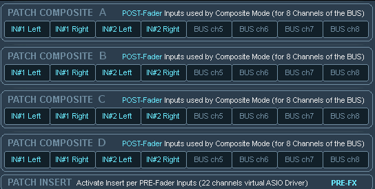

Attached a system settings GUI mod idea for PATCH COMPOSITE.
- Something like that?
- PATCH COMPOSITE mod.png (15.31 KiB) Viewed 8587 times
