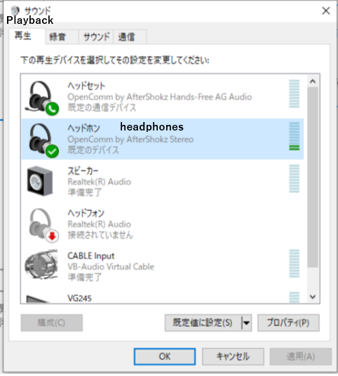

1.No sound (No audio output)on sites with video or audio in the browser
2.Headsets make a loud "beep" sound.
3.Microphone isn't working
Now, the users already uninstalled VB-Cable to avoid above issues.

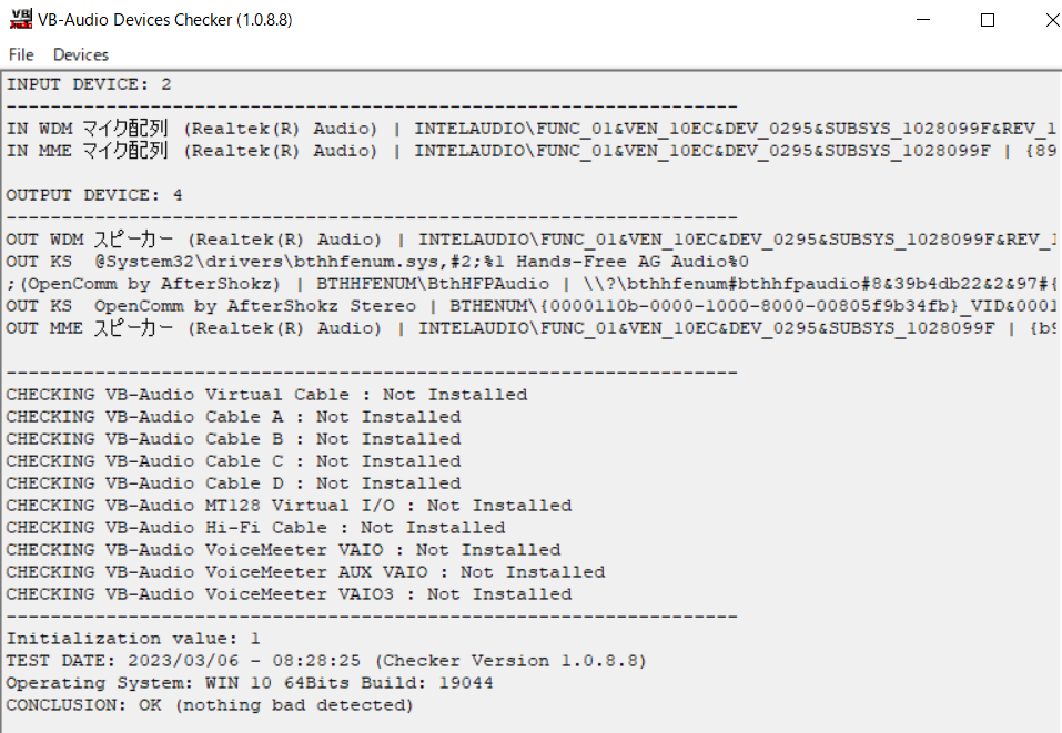

・the VB DeviceCheck (viewtopic.php?f=7&t=688
Even though the CONCLUSION of the checker command says OK(nothing bad detected) and reinstall VB-CABLE,
The issue (cannot hear sound on the headsets) still remains.

・Default playback and recording device has been set up properly.
I attached screenshots about the issue no,3.

the driver installation is OK. your problem is simply an audio configuration problem.

So, In your screenshot, i can see the CABLE Input is not set as default playback device, so does not get any PC sound.
