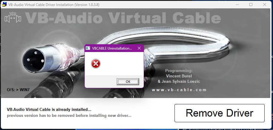

So for some reason when I installed VB-Cable I didnt get some of the drivers installed. So when I reopened the .exe to uninstall it and then reinstall it. But when I pressed the "Remove Driver" button I get this error: https://gyazo.com/63cd7c70816f2ce1568b24dc831927a3 .

I believe this is due to not running as administrator. I got the same thing doing some initial testing. Also, when I used the "-u" command-line switch to uninstall, and in that case that blank dialog pops up automatically (you can see in my screenshot that "Remove Driver" isn't inverted, so it hasn't been manually clicked).
Also, to add to the original bug report, if you click Ok, the setup program ends without uninstalling anything. If it matters, in my case I'm running the x64 installer and don't have anywhere to test the x86 installer.

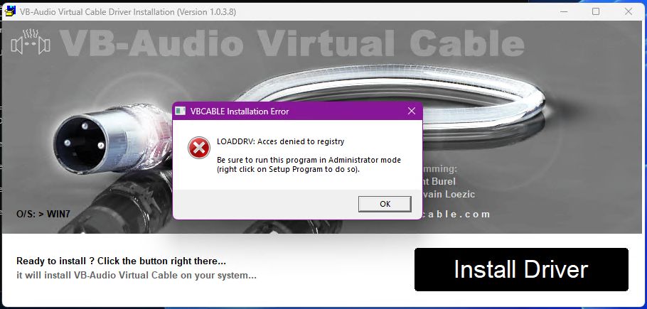

If you try to install without admin rights, it does show a legible error:
There is another bug -- when I click OK from the admin error message, it tries to navigate a browser to https://end.pagesperso-orange.fr/ which (in Firefox at least) returns an SSL error (SSL_ERROR_RX_RECORD_TOO_LONG). But given your other pages (the store etc) I'm guessing this is an old invalid address.

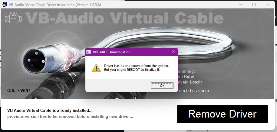

When I run "Uninstall/Change" from Programs and Features, I get a UAC prompt, then the same "Remove Driver" pop-up with a success message.
