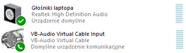

I am asking for help because I am fighting against the system so that the virtual cable driver will normally work for me. I have two devices on which Windows 10 1803 build 17134.48 is installed and it stopped working properly on Surface. I've reinstalled the drivers, but I have the impression that some incorrect instructions have been generated somewhere in the system that did not get removed correctly after uninstalling the driver. There was also a restart of the system after the uninstallation, as the author of this driver advises.
On the Surface device, I have a problem that the virtual cable does not receive sound from the microphone and does not transmit it to its virtual microphone. screen with a configuration that should continue to work on Surface and stop. On a Lenovo laptop, everything works normally, even after updating the system to the latest build version.

- Odtwarzanie.png (29.08 KiB) Viewed 29044 times
- Nagrywanie.png (12.05 KiB) Viewed 29044 times
