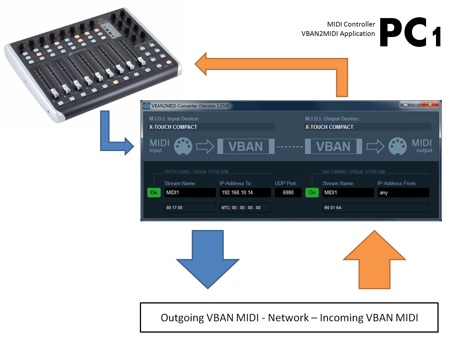

1- connect your controller on PC1 with VBAN2MIDI to manage outgoing and incoming VBAN MIDI STREAM
On the left side, the outgoing stream: MIDI Controller out -> MIDI Input Device -> VBAN2MIDI -> Target IP Address
On the right side, the incoming stream (MIDI feedback) from any IP Address -> VBAN2MIDI -> MIDI output device -> MIDI Controller In.

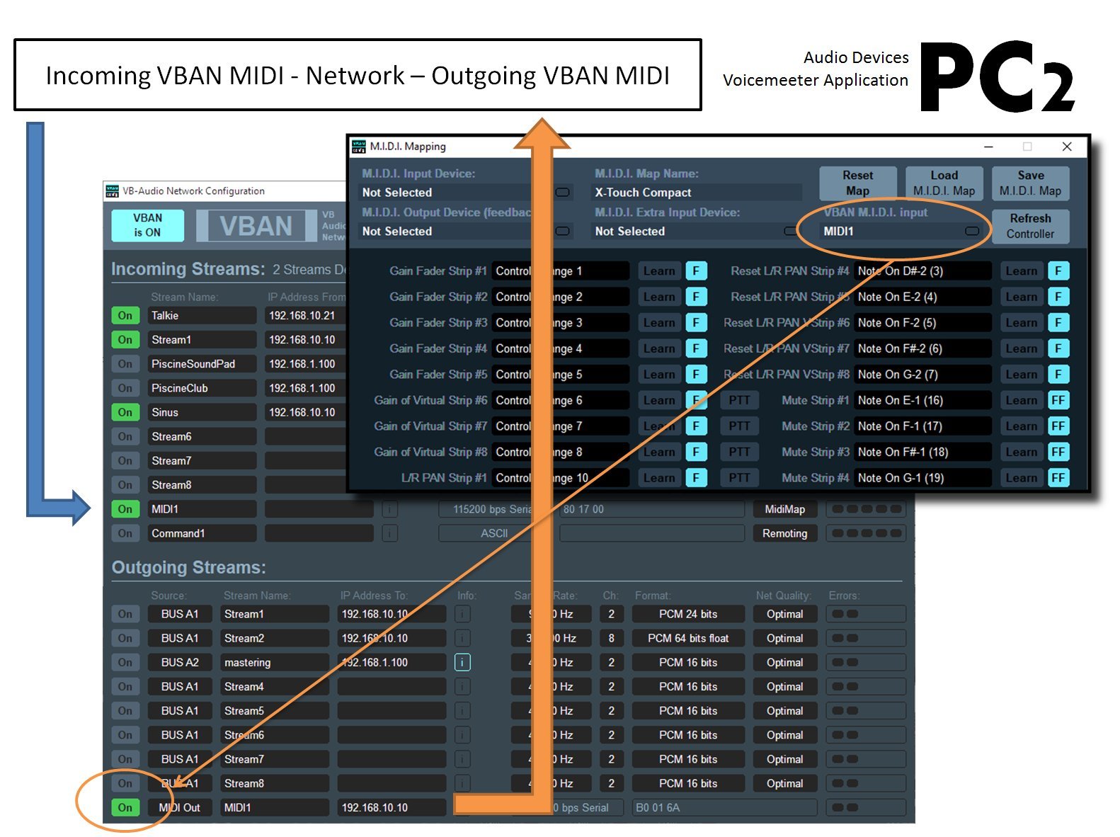

2- the MIDI mapping always take in account the incoming VBAN-MIDI stream activated in the VBAN -Dialog BOX (check the name is MIDI1 on transmitter and on receptor side).
You can see incoming MIDI message in VBAN Dialog box and go in MIDI mapping to learn on desired control. There is no option related to incoming VBAN MIDI message in the MIDI mapping Dialog box. "VBAN MIDI Input" in MIDI mapping dialog box is an info box related to VBAN MIDI outgoing stream and should be labelled " VBAN MIDI Output" instead.
For the MIDI Feedback, you simply have to configure the outgoing VBAN MIDI stream in the VBAN Dialog box. and select "MIDI OUT" to send the MIDI feedback to the PC1
