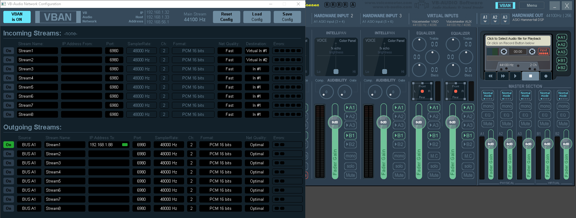

Posts: 2153
Re: Receiving a VBAN Audio Stream
1- check that Voicemeeter transmitter works correct (audio monitor gives a correct sound)
2- is it on a local wire or wifi network ?
3- could you post screenshot of VBAN configuration page on transmitter and receiver side ?

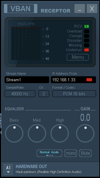

tomc
Joined: Sat Sep 03, 2016 5:37 pm
Post by tomc »
Yes,transmitter works correct
I tested both local wire and wifi network
receiver
receiver
is configuration ok?
