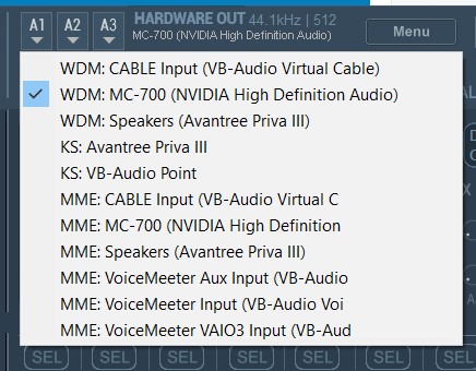

Re: Potato UI freezes/unresponsive after extended sleep
Hi Vincent,
Thanks!
I don't use MME, only a WDM device:
More info:
I use VAIO1 as default audio device configured without exclusive mode
I use VAIO2 (AUX) as audio device for exclusive mode enabled applications (Tidal, Roon) to bypass Windows audio mixer and configured with exclusive mode (In both the Windows audio device configuration and the general WDM Input Exclusive Mode in VoiceMeeter)*.
Perhaps related?
*Not sure about the sonic benefits for this but I do get emotional reassurance
from Roon's purple lossless indicator, available only for Exclusive Mode:
I'm aware that VoiceMeeter is still a software mixer in the path, so not really a direct path to device as Roon believes in this configuration but I do trust VoiceMeeter's audio path more than Window's and in any case I guess one less software mixer/resampler in the path for these audio apps.
Apart from this VAIO & VAIO AUX non-exclusive/exclusive setup also changed in this HTPC is the HDMI card (from Intel built in to nVidia) which subsequently also replaced the HDMI audio interface.
So - summary of changes between previous setup, for which didn't had these VoiceMeeter UI hangs:
1. Move from Banana to Potato (Also donated to show support!)
2. Change HDMI Audio from Intel to nVidia
3. Change of Audio endpoint (HDMI Pre-pro) from Emotiva UMC-200 to Emotiva MC-700
4. Configuration of VAIO and VAIOAUX to support both Exclusive (Tidal, Roon) and non-Exclusive (Chrome, Spotify, etc) applications
5. Use of ElementLT as VST plugin host with VoiceMeeters Patch inserts
Quite a lot, I realize
Which one would you suspect the most?
Thanks!

- Posts: 2208
ok, so i would say you should not set WDM Input exclusive mode to YES in Voicemeeter
(but you have no hardware input so should not have incidence).
i also recently bought an Emotiva MC-700 and i'm not fully happy with this device... should start by this one.
Voicemeeter cannot freeze because VAIO (whatever you connect on) and cannot freeze with Virtual ASIO (because totally not in same process).
